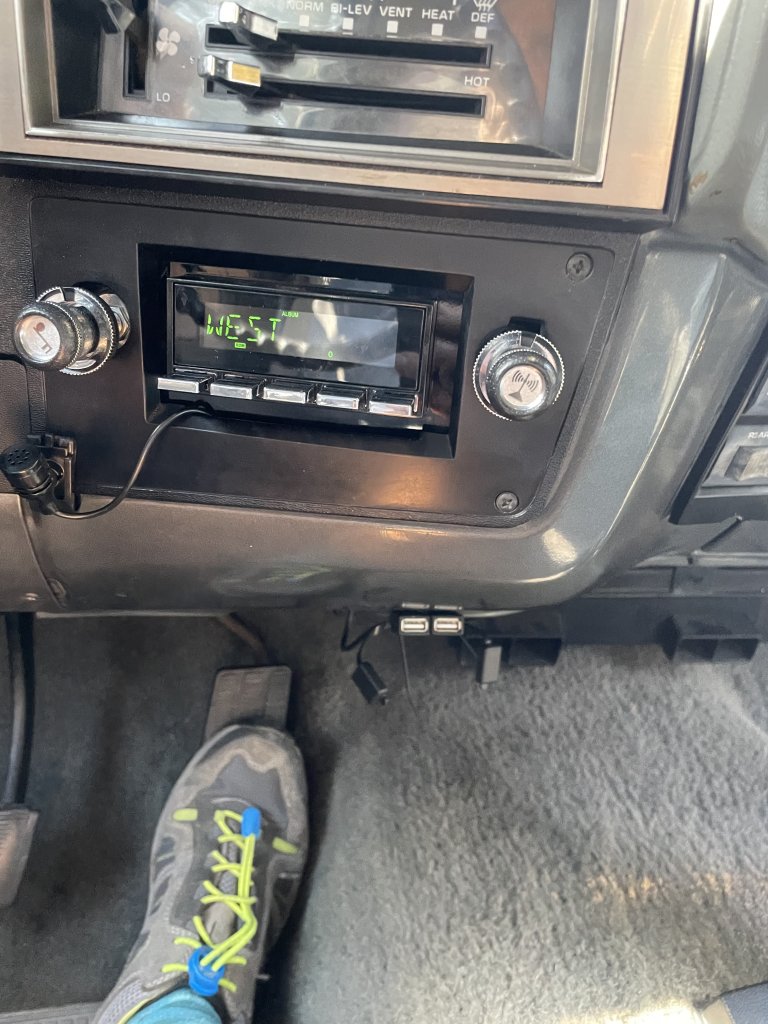

I looked at lots of options and ended up with a Retrosound radio. It has Bluetooth audio and phone, but still maintains the factory dash and 2 knob look. It has all the inputs and outputs for modern stereo accessories. Installation is fiddly, but not hard. Overall, I am pleased with it.
