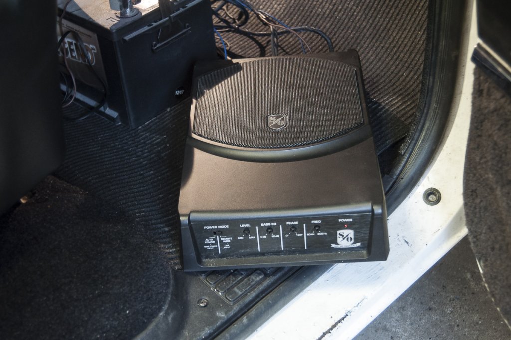

Did you put the carpet on the speaker adapters? All the ones in my Google search are just a plate.
Also, does the sub amp offer power for the other speakers?
1- no got a rest over carpet from back side cab isolation
2-hummm not shure got to search for sound orderner sub ;)
