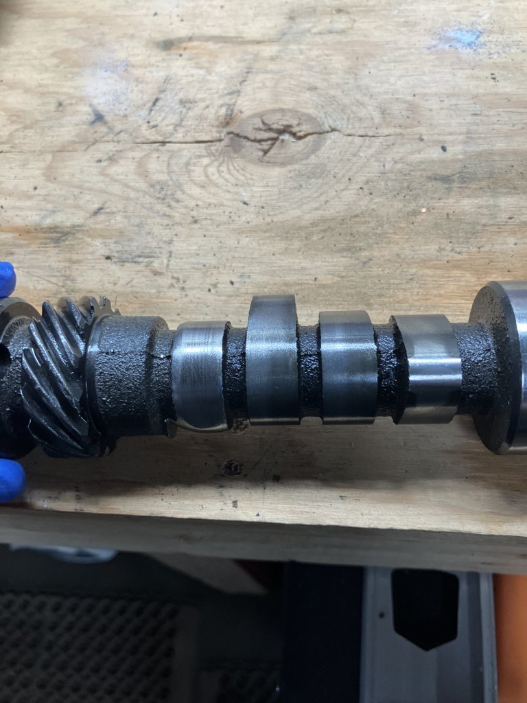

I recently swapped a mildly built 355 into my truck and now has a lifter tick. I’ve put about 4000km on the motor and it was broken in before I bought it, and recently hearing a lifter tick, still getting oil through the rockers and they all appear to be opening the same amount. Was told it has comp cams heavy duty roller rockers, lifters and valve springs, and has a comp cams magnum camshaft. Did my valve lash again, checked manifolds, exhaust leaks but don’t know what to try next, added some atf to the oil a few days ago but the noise is still there. Still feels fast and solid but don’t really want to wipe out a cam lobe. Should I just buy new lifters and replace them. And if so any recommendations on lifters, thanks

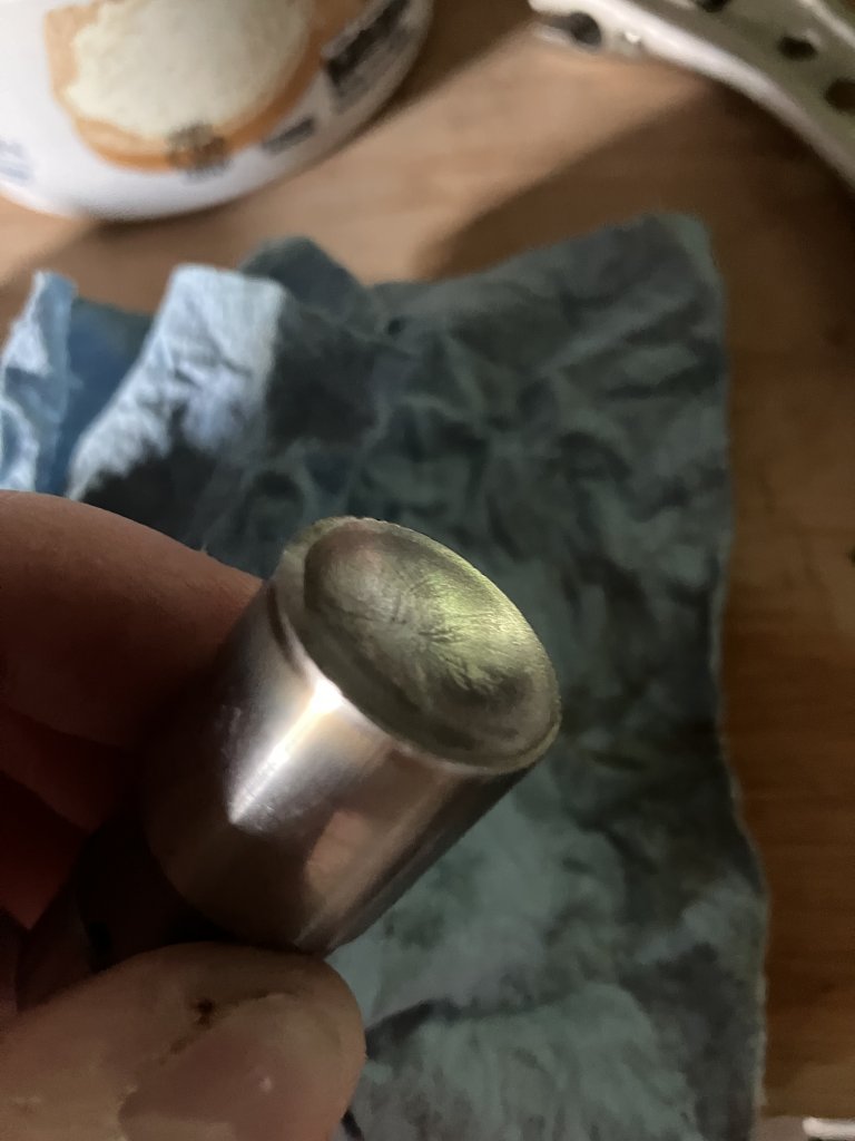

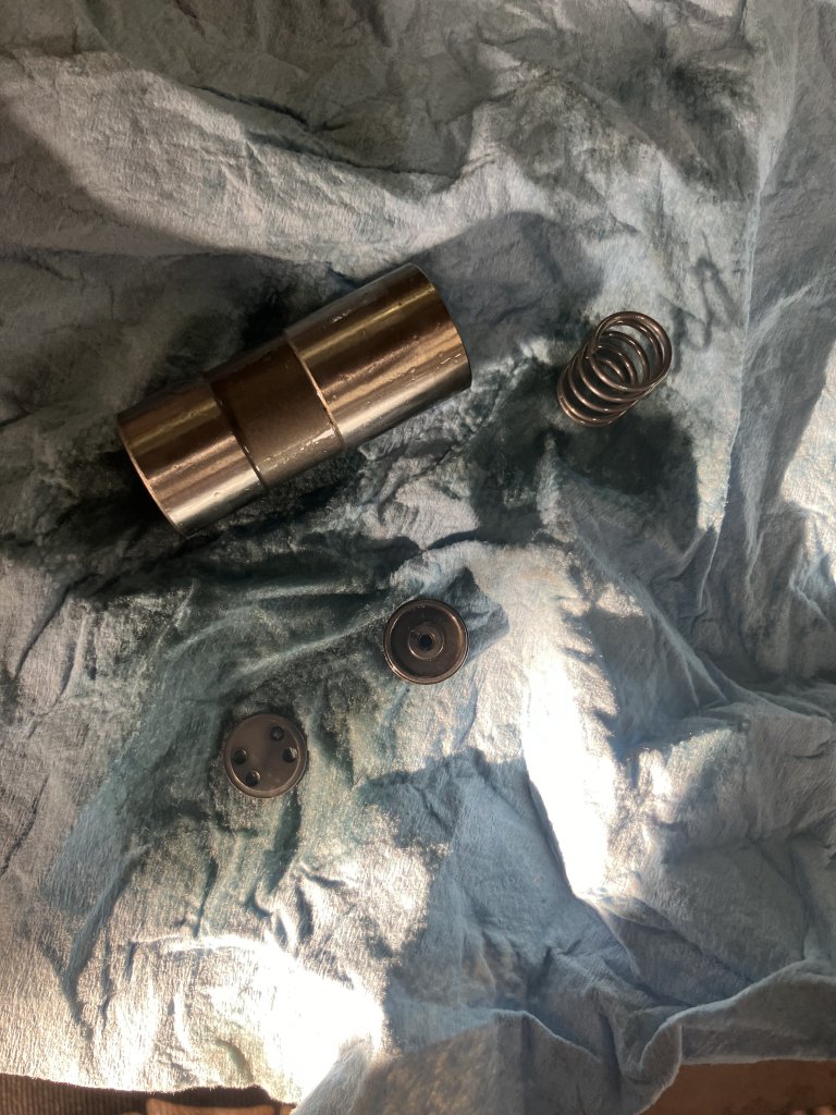

Using a new lifter on a used cam is not necessarily a deal breaker, lifters used to get warrantied out,without tearing down the engine. Look at the lifter make sure it still has a crown,if it's flat or dished, I don't think you will be okay. With the engine running you can push on the rockers with the heal of your hand to identify the bad lifter.. Because all the push rods are rotating I think you'll get away with a lifter swap.Make darn sure it's not a plug wire,plug boot,exhaust flapper,first though. Treat your new lifter like it was a new cam and lifter,do a break in and verify that the pushrod is spinning with the engine running.Of course in a perfect world you'd change the cam and lifters,but real world if you have to replace one or two just do the verifications I told you.
