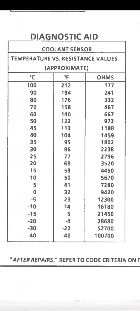

I'd probably start with the CTS on this one.

you can measure the resistance across the sensor and compare it to the table to see if the sensor is correct.
This is cool!
Do you know what other years it covers? I think they used the same coolant temp sensor for many years.

it will be in the emissions and drivability manual for your year. I pulled that one from 1991. I have a 1990 and keep the manuals downloaded to my phone for easy reference when I have an issue. all the manuals are in the reference library. a great resource.

drove the truck today to get some fuel 15 miles or so, when I got back I performed the IAC reset and the truck idles lower now and is alot smoother, I did forget to ohm the coolant temp sensor, but tomorrow before I start it up I will do that

33° outside temp, coolant temp sensor reads 8,980 ohms
squaredeal91
Mar 10, 2023
3,119
5,891
Cave junction Oregon
Greg bush
1991 SB
5.9 Cummins 12 valve
looks right to me? both Celsius and Fahrenheit are shown in the table...
math was always my worse subject lol. Now I see it's right on. Somehow I added a digit in my head.
