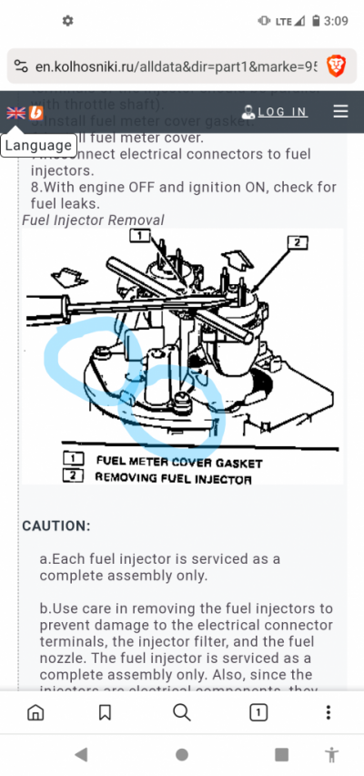

I replaced all the vacum lines today and was staring at the injectors when I noticed fuel leaking from a gasket into the venturi (maybe metering block) not sure if a TBI has one? but thats kinda what it looks like to me, I tightened the torx screws a few turns, ( I circled 2 out of them of them in the screenshot) they were not tight at all, the leak stopped and the motor instantly started to purr all nice and smooth.
I am crossing my fingers it runs like it should tomorrow when I fire it up.

Im glad thats working for you :) (you know what i mean)
