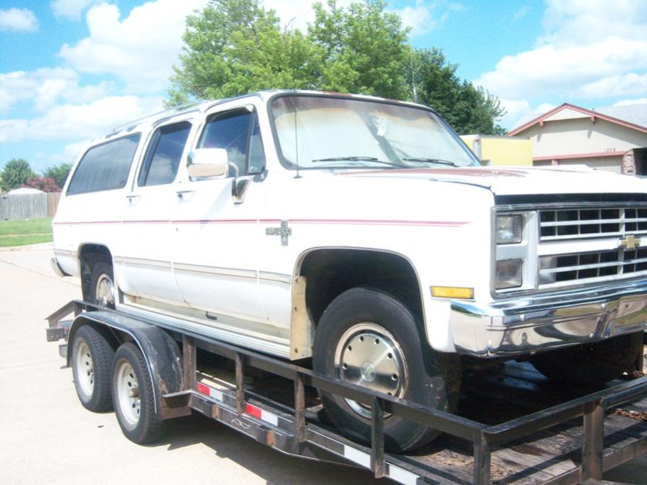

Its actually an 85 Body. He wants $1400 for the whole truck with the new motor and trans, but its Turbo 350 and cast iron Tcase, so not sure if its NP203 or NP205. He said he'd pull the motor and trans and sell the rest of it for $400. I asked, its bench seat model. You ever get interested in something like this let me know. I'd probably split the $400 with you. You can have the body and interior, and I'll take the frame and chassis parts to convert my 2wd Burb to 4x4.

How about HRPC and 89Sub go in together on that Burb and you both take what you want and then whatever is left over is divided and sold. By the end you may end up with a free body and a free frame between the two of your! :D
That's the way I think, but there is also many miles between us. All I'd need out of the thing is the frame itself and the front axle which I'd have to convert to 8 lug since my 2wd Burb is 3/4 ton and already has a 14bolt Full Float 3.73 rear end. So I'd use my rear springs and rear end. The hope that front 10bolt is 3.73 gear and just take off the 6 lug hubs and put 8 lug hubs on and I'd be in bidness with a 3/4 Fo Buh Fo Burb. My Body only has 2 spots of rust at the rear side windows, about the size of a nickel. Easily fixed. No dents either. Just needs the surface rust sanded off, then repaint it.

DOH !!! And I guess I'd need a center hump too for the Tcase to fit. But, we could always cut that out of 89S's burb too instead of butchering the new rust free or close to rust free body.

Yeah, the center hump thing is not a hard thing to remedy:)
