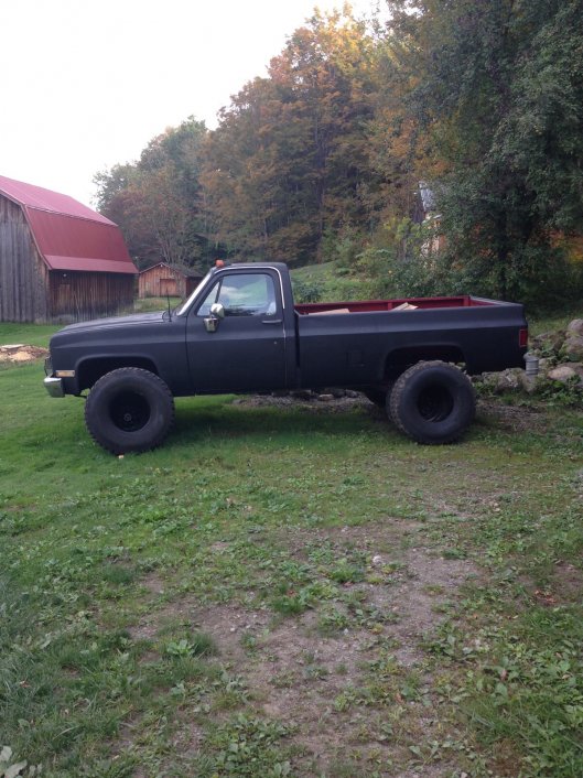

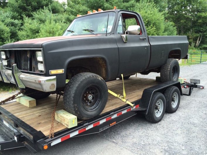

I'm in the exact same boat as you bud, bought my 87 k20 advertised as a 4" lift but not 100% sure, it's also has been Dana swapped front and rear and I have 16.5" wheels. Bought 37's for it and they will clear the rear ended fine but the front end is kind of tight. I just ordered 2.5" blocks with longer U-Bolts for the Dana 45 up front and I will let you know if it clears the tires after. The truck sits a little lower in the front now so this should level it out as well.
pic shows you how big those 37's really are

These are the 33's
