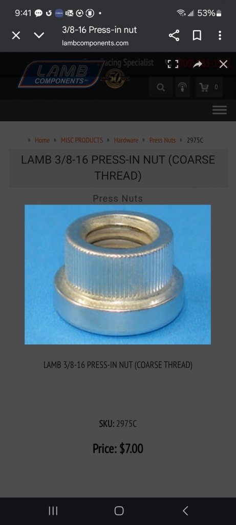

I’m dense this morning maybe. Not understanding the connundrum.
Holes in mount plates aren’t made for a carriage head to grab so sort rules out carriage bolts. And there’s just bolting to the bed floor, not through the frame, correct?
I’m not seeing the use for blind nuts, press in nuts etc. or are you wanting to put nut serts in the floor because can’t reach the locations underneath?
Regardless, 24 bolts seems excessive. Especially since it’s for show. I’d probably forego half the bolts. That’s a lot of holes and drilling for a big chrome light bar! (But it will looks cool as hell!)

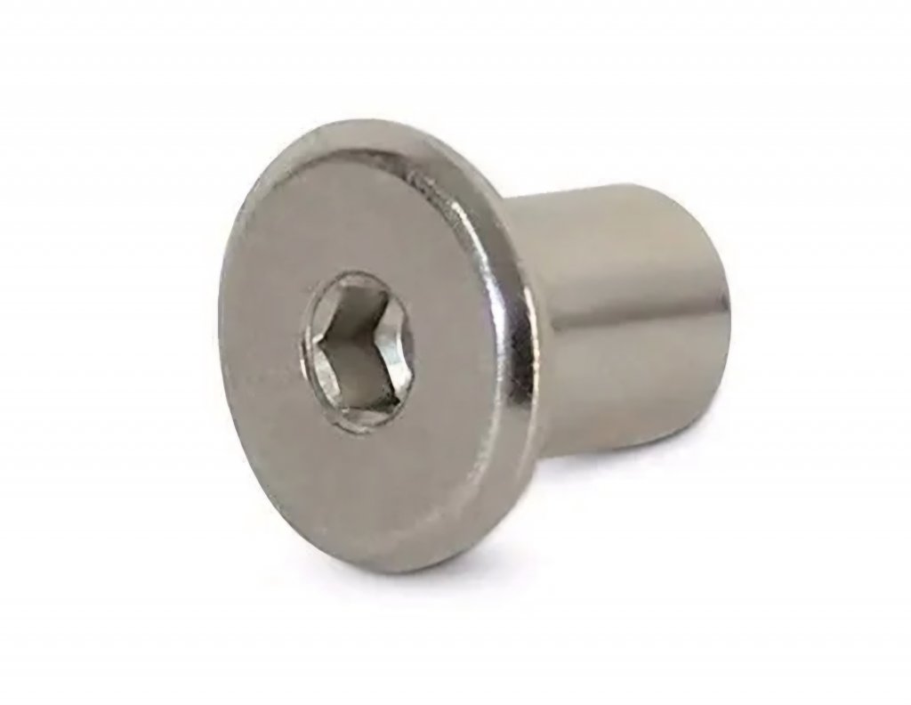

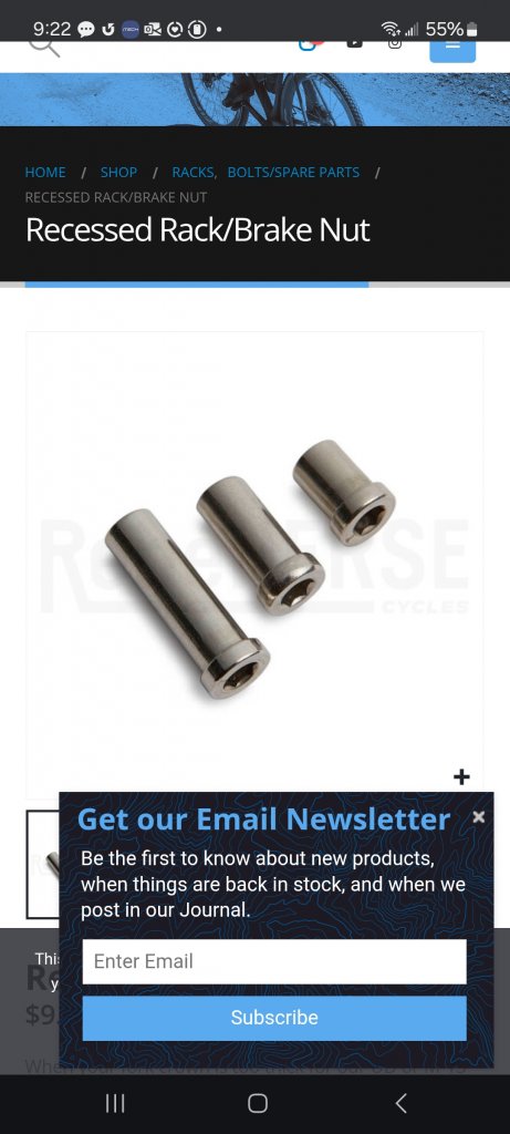

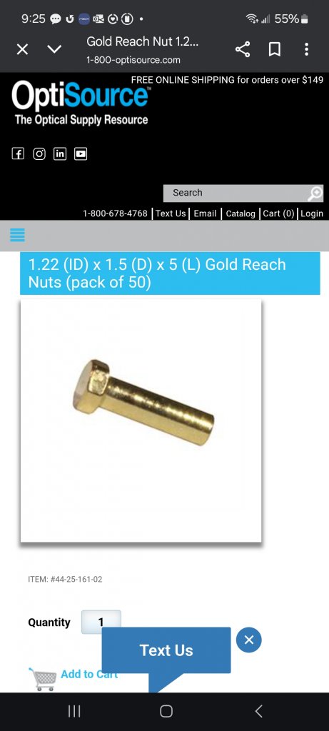

I believe the original hardware would have been a flush mount bolt on both sides of the tube, one being male and the other being female. Similar to a couple that Ricko posted.
That’s exactly what was in that one you got from me. One bolt was male, one female, both with Allen heads on them. They met in the middle of the bar and screwed into each other, leaving only a dome shaped Allen head on each side.

Well, the stuff I ordered last time didn't work, there were ribs on the shank of the binding barrel toward the head that were too large to fit through the hole. I suppose I could have hammered it through, but the chrome finish on them wasn't really good, and the screw head on the other end didn't fully cover the hole in the bar. I found some chrome plated 1/4-28x1.25" allen drive button head cap screws, chrome plated 5/8" diameter washers, and some 23/64" diameter by 3/4" long coupling nuts in the same 1/4-28 thread pitch that I can use. The coupling nuts can be used at each end to make the 1/4" bolts thick enough to fit snugly in the holes (it'll be 1/64" smaller than the diameter), and again in the center to join the screws together. I got a 1.25" long one for the middle. Far from an ideal solution, but it is amazingly difficult to find chrome plated hardware in the correct diameter and length with matching thread pitch. It's like the world's fastener manufacturers sat down and had a summit meeting and decided to make it impossible to join 3" chrome tube together stylishly lol. I had to order some of it from McMaster and some from Hillco Fastener Warehouse. Fingers crossed the chrome finish on the cap screws is nice. That place doesn't have a local store I can return it to. If it's no good, I guess I'll just have to get them re-chromed properly. Hopefully something that small will be cheap and not take another 8 weeks. I can't believe It costs $250 for some damn fasteners... and I haven't even got anything nice to hold the top hoops together yet, not sure what the thread pitch is on that. I need to take one in to work and use the sizer. Then I still need 24 bolts, nuts and washers to hold the feet down to the bed floor. I bet I end up with almost $500 worth of bolts lol. Anyone have any idea how long of a bolt I'd need to hold it down to the bed floor? I know the gas tanks are right there, I don't want to get something too long.
