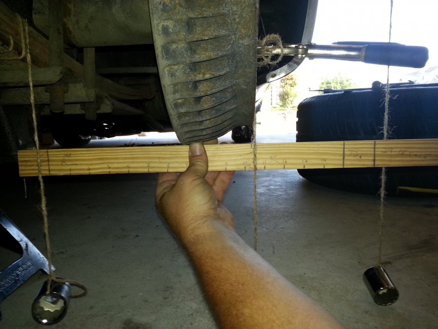

Im planning to put some new wheels on my truck and I was looking at 15''x12'' for the rim size, just unsure about how much backspacing/offset would give me what on these 72-87 trucks (mines an 86 3/4). I'd like for my new wheels to stick out about 4'' all the way around. If any one has any experience with this then please elaborate on your wheels and how much backspacing or offest you used and how far they stick out, thanks.

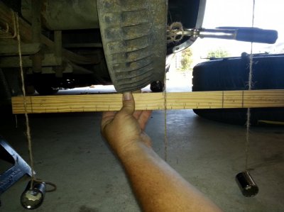

If you hang some plumb lines you can easily find out. Also it helps to kniw that a 12in rim is 13in wide.
