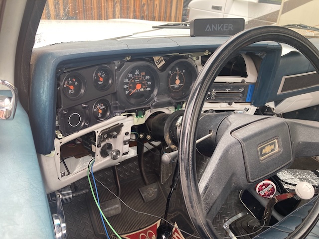

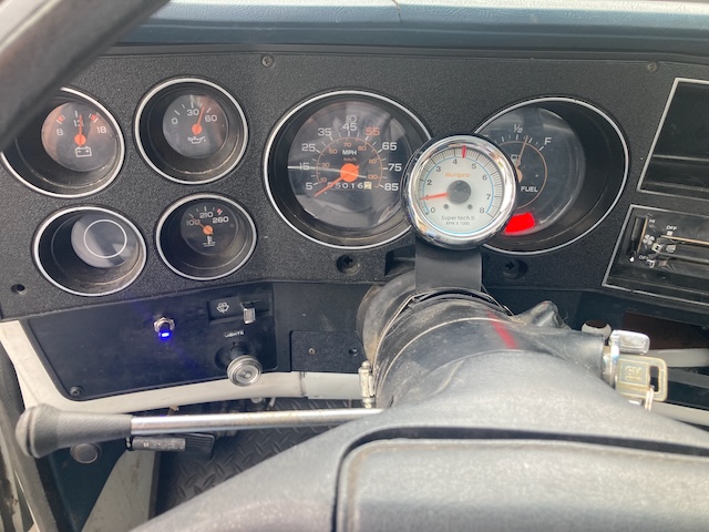

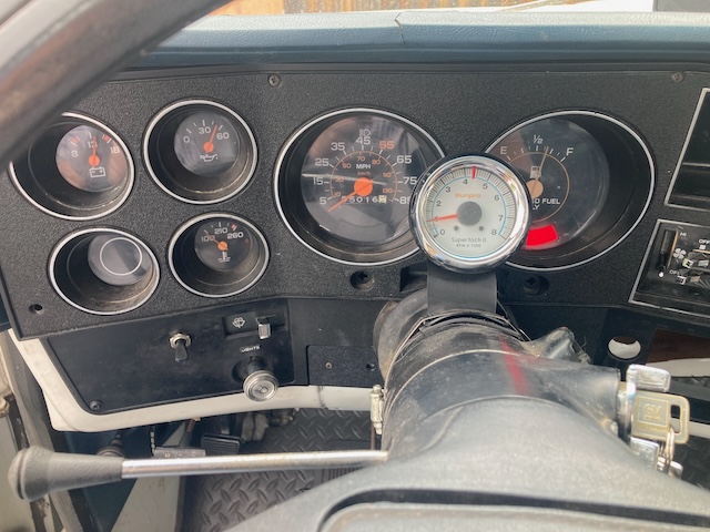

Coolio, today I looked under the dash and saw the switch, with a blue and green wire. I pulled the plug off, and connected two wires (blue and green!) to the connector, ran them to a switch, with a ground, and installed it in the dash..When the blue light is on, the back up lights are on. That's what I wanted, thanks aurora girl and jgonick
