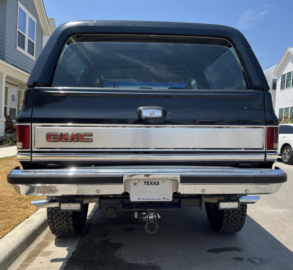

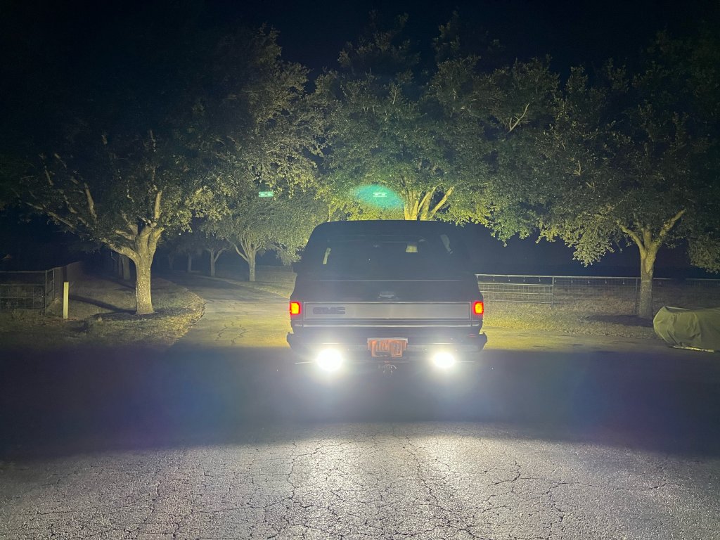

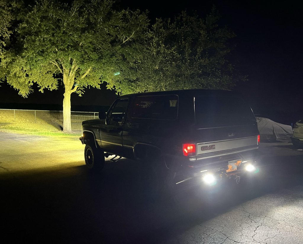

i was going to add some auxiliary LED lights to come on when i go into reserve but was worried they would be too bright for other drivers in parking lots etc., so i added some auxiliary lights that i turn on with a switch. i don’t use them too often but a bonus is having the option to use them when fussing with a hitch or setting up a campsite.
all that said, i may still tap into the reverse wires, add some more auxiliary LEDs, and just aim them pretty far down so they aren’t blinding to others- we’ll see…
my jimmy is both my daily driver and hunting/camping rig, so have to find a balance on practicality vs. overkill.
