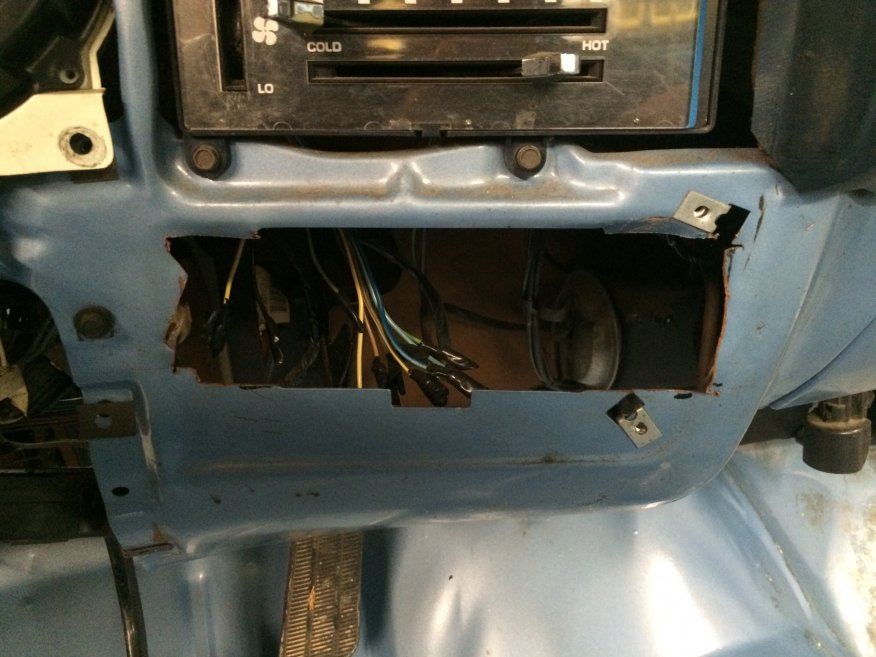

UGH! Stupid PO!

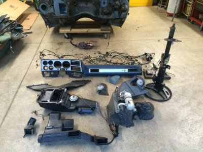

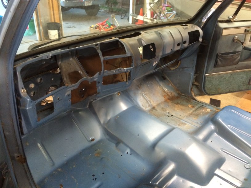

Making some progress.:party36:
I also have a bunch of extra parts to sell.

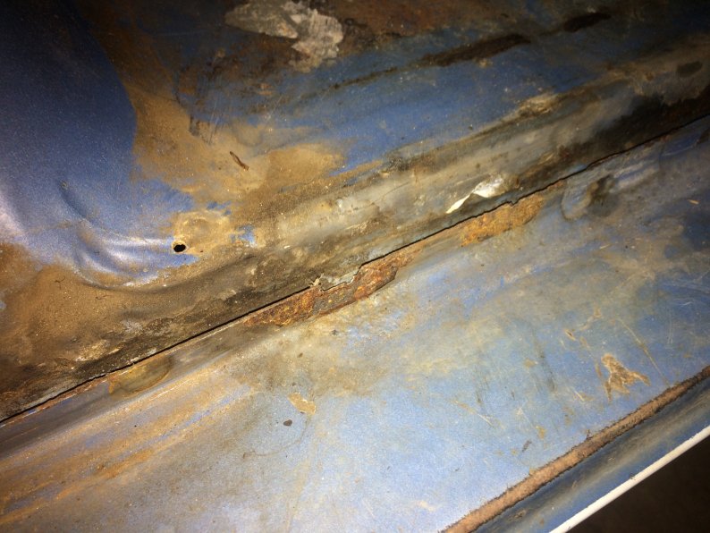

The rust tha MUST be stopped! This seems to me to be the most vulnerable spot on these cabs. On the last cab I repired I eliminated this channel. Mot sure yet what I will do on this one. If I keep the channel I will have to check on it at least once a year to keep it from rotting for sure. I wish GM would have done this different.

I think one of the biggest issues with not only these trucks but a lot of trucks from the GMT400 era was not only that channel but the fact they would put screws right through the sheet metal do a piss poor job in protecting it. Then you get moisture all god knows what else up there causing grief.

Yeah, along with whatever comes off your feet inside all runs over there where it soaks into the floor insulation and sits in the channel. Add to that moisture wicking up from inside the rocker. Once its wet it never ever dries out.

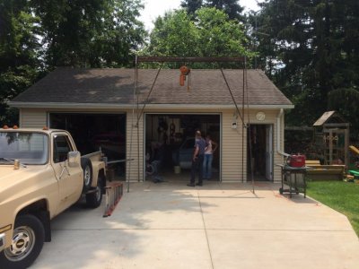

Put my gantry crane up for lifting the cabs and such. Not meant for a lot of weight but it works well for cabs and boxes.
I would tell you to use POR15 but everyone seems to be getting their panties ruffled about using POR15 for some reason. But I Used it on mine and it doesn't rust no matter how much moisture it sees! Have to apply it to bare metal and chemically convert the rust first though. Just follow the directions and it will never rust again!
And yes you can paint over it with an etching primer and then paint.

@ MadO, I see everyone getting all wound up about POR. I plan on using it on the floor pans and in the channel after a good blasting.
