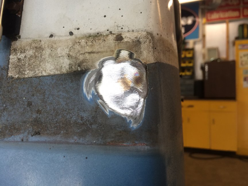

Working on my TIG-FU!

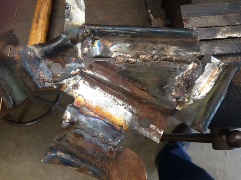

Getting there.

Nice work! I had the opportunity to try a TIG welder a few weeks ago. It was awesome, and now I really, really want one, along with a plasma cutter. $$$$
