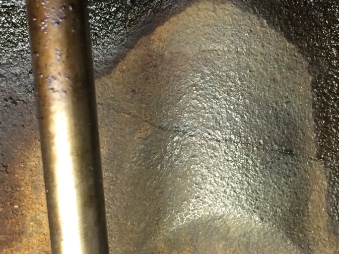

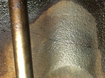

So while chasing my coolant usage issue I found this. It wasn't washed like it was leaking but it is certainly a crack! Anybody ever seen a crack like this that wasnt leaking?

Did you build the motor? Is it sleeved ?

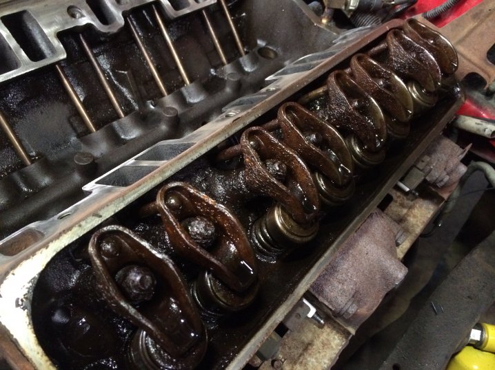

No, I have no history on this motor at all. I know someone had the intake off at some point and while it wasnt "washed" cleanly there were some old gunky puddles of coolant in the valley. It was using coolant very slowly and not burning it. The rockers are rusty and gunky and it has the yellow green snot residue in the valve covers. No water visible in the oil or on the stick. I don't know if it's sleeved. I am going to assume it is leaking coolant there but not very quickly. I will also put up some pics of the valvetrain. Basicly this motor is sick and going on the books to be replaced. It ran good enough to put back together for now and move on the the body work I guess.

Yummy!

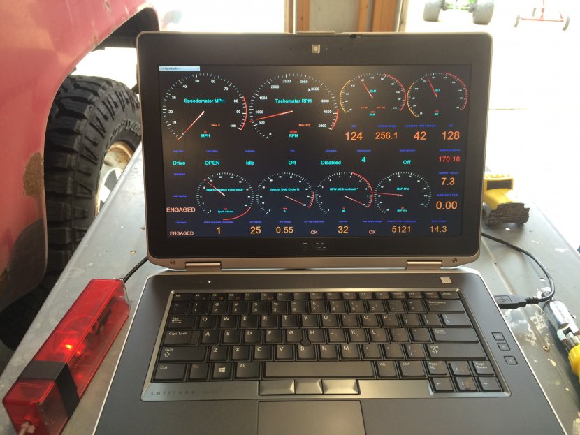

I made my cable and am connected to the ECM logging data! This is sweet!

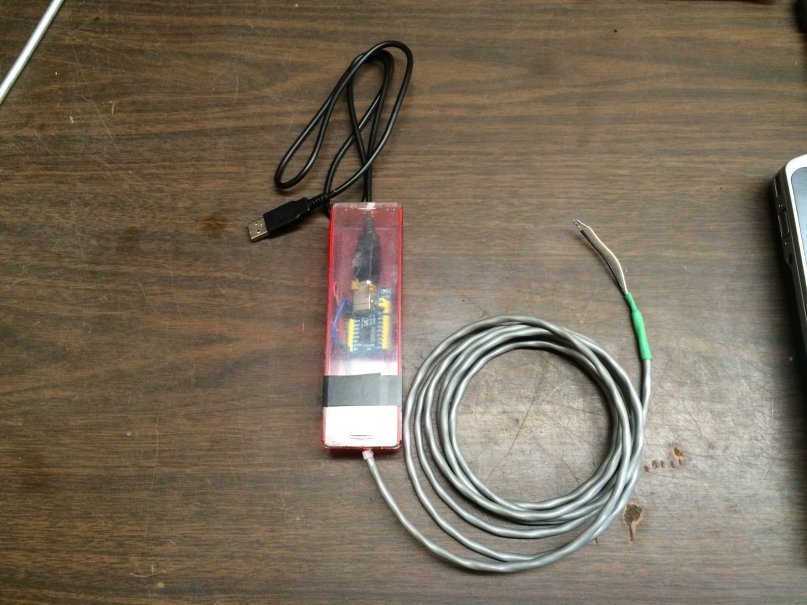

here is my $10.00 cable.

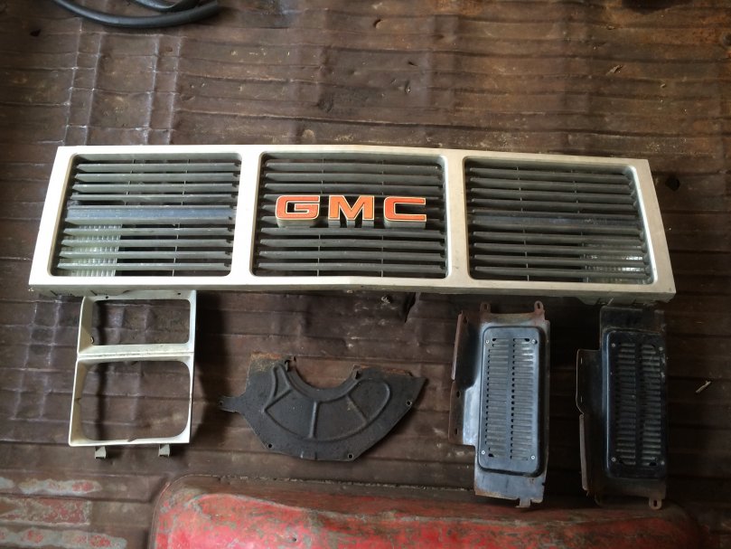

Yesterdays $25.00 score!
Where is this crack? Can you get another backed up pic so we can see where it's at? I see a pushrod I believe. So does this mean it's in the valley of the block?
