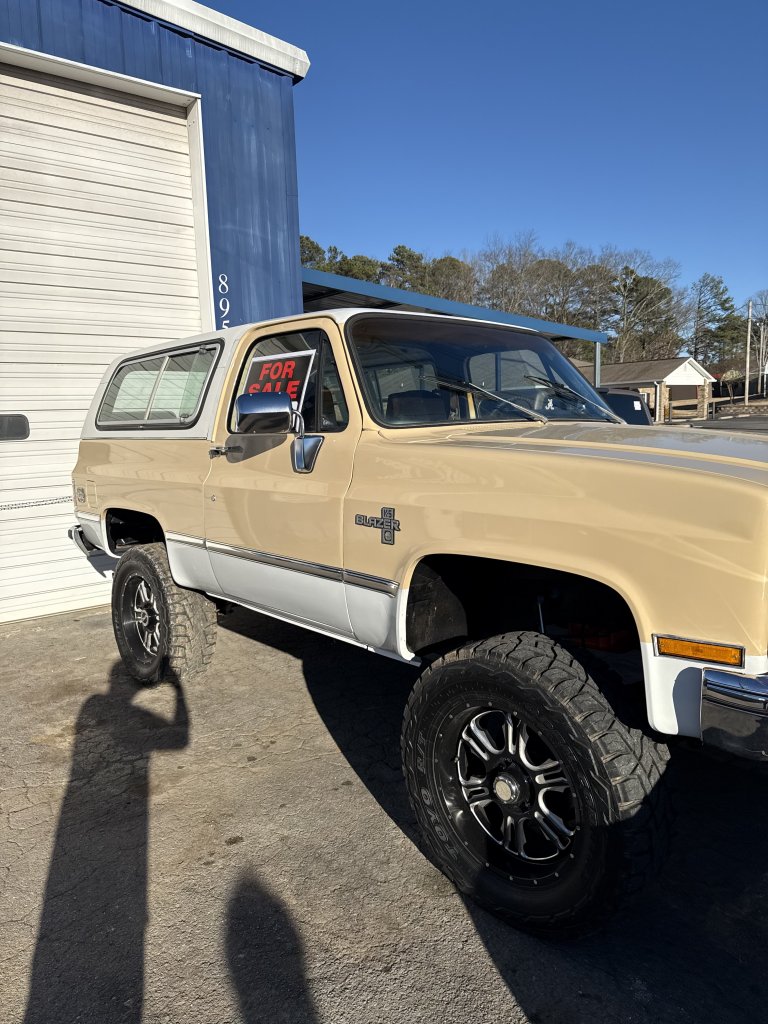

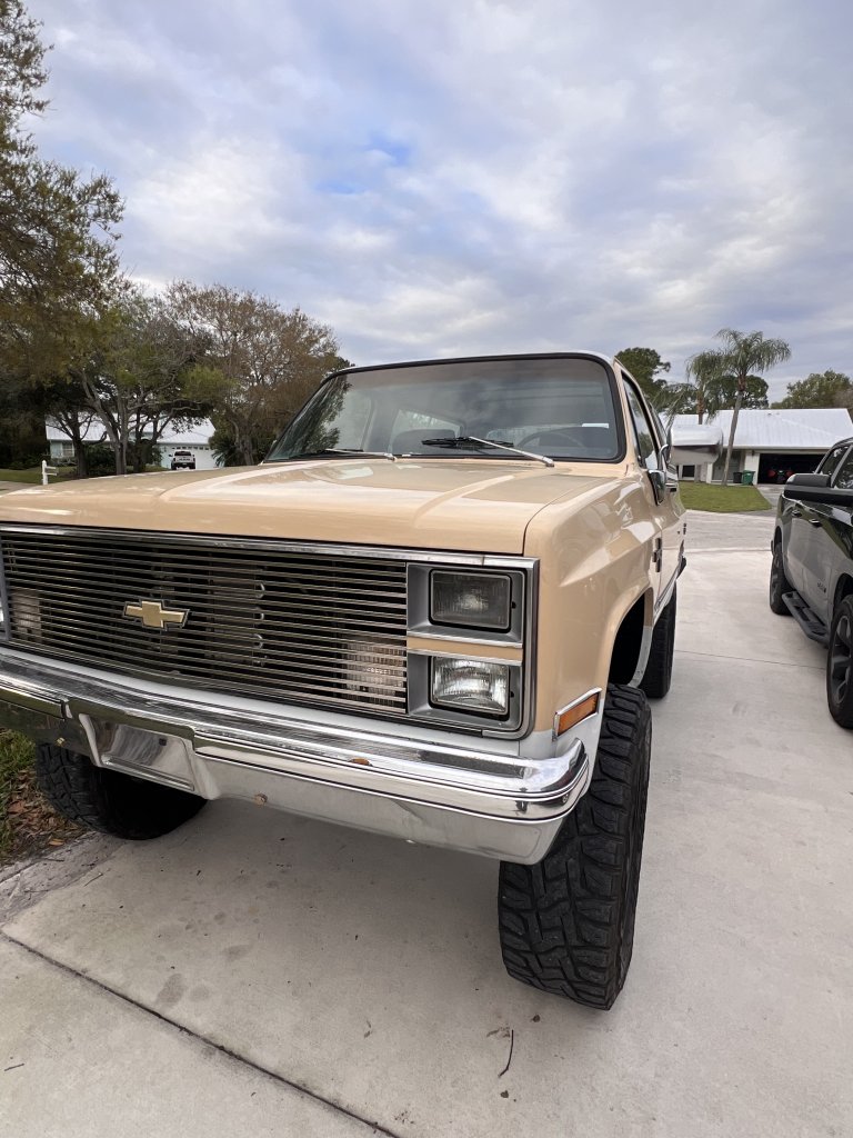

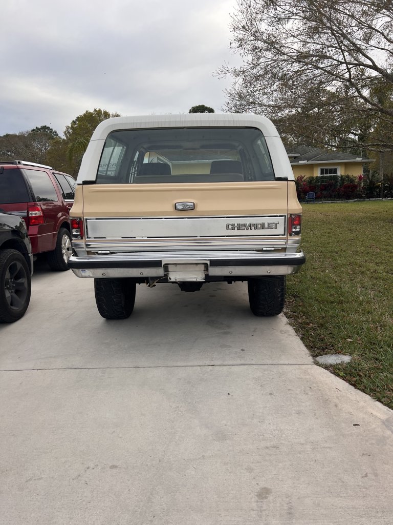

Thank you brother. I’m looking for that axle…when I do it I would change the gears in the front and be ready to rock the mall.

@BryanS that Blazer is really nice! I remember you posting those pics. Looks like someone used 88-91 bumpers front and rear with some 80s side molding to over the holes on the front. Looks clean like that.
I wouldn’t rule out all options and see what you find. Wouldn’t be too outrageous to swap both axles either if you found a set of good 3/4 ton 8 lug. Front axle is basically a direct swap as is the rear. (I think. Idk if there were different rear shock mounts. But easy to tell).
Just spitballing options I’d consider. I don’t have all the axle diameter spline counts etc memorized. But finding a 8 lug 14 bolt sf, you may be able to buy new axle shafts with 6 lug hubs as well.
Some research and guys on this forum should help you figure out all the options to get where you want to be. It’s all time + $$ or $$$.
