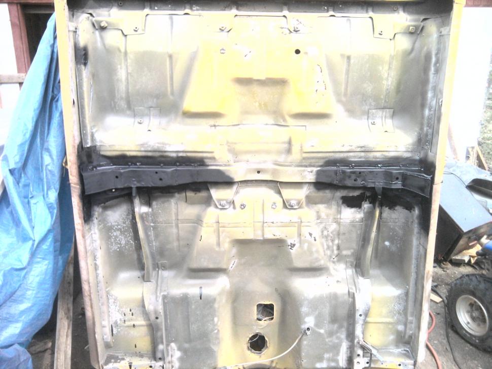

Michael I grew up in your area mostly willow hill and newton
this is a picture of my crew but the front rockers would be the same
