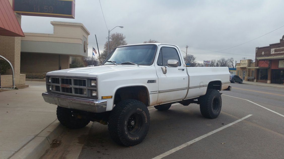

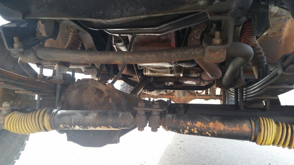

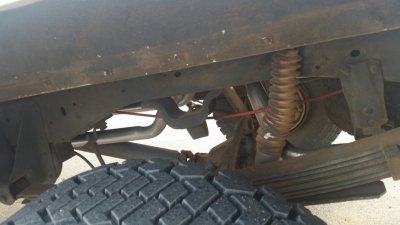

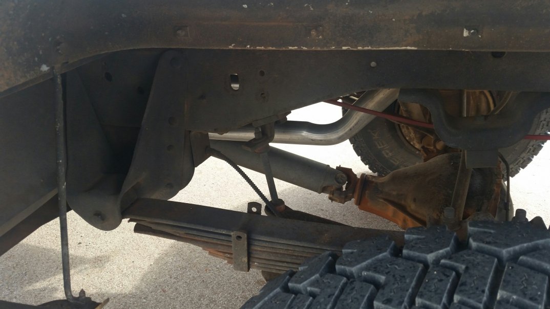

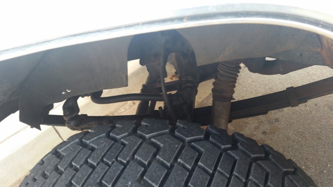

I recently bought a truck that is lifted and I know very little about lift kits. The truck has 35 inch tires on it. I would like to lower the truck a little. I was thinking of going to 33 inch tires and was curious what the minimum amount of lift needed for 33's would be.
How do I tell what type of lift I currently have? Meaning body or suspension. Is there an easy way to measure and see how much lift is currently on the truck.
I wasn't really looking for a lifted truck but I wanted a 3/4 ton with a big block, so I went ahead and bought this one when I found it. The truck is a 1983 GMC K2500.
I included some pics if that helps.

If those are 35s, looks like 6" to me. Hard to say on minimum lift for 33s. Depends on tire width and wheel back spacing. Hard to beat a 4" 33 combo.

It is hard to tell in your pics. Do you have lift blocks in the back? Meaning is there a square block sitting between the axle and the leaf spring pack? If there is crawl under and measure how tall it is. I'd guess a 6" lift...
EDIT: In the second picture where you show the front axle I can see all the way back to the rear axle. You have lift blocks on it. I can't tell how tall they are though.
So it looks like you have a suspension lift on it. To drop the rear it would be taking out those lift blocks and replacing it with some shorter ones. To drop the front you'd need to buy new springs, or some say you can remove a leaf from the spring pack (I've never tried it that way).
Will you be hauling much in your bed, or towing a trailer? I ask because often when lets say you buy 4" aftermarket lift springs in the front and a 4" lift block for the rear the truck will be sitting higher in the front. This is because the stock springs in the rear of the truck have sagged a bit in the 30 years they have been used.
If that is the case maybe a 3" lift in the front and a 4" block in the rear will make it sit more level. Although with the weight of a big block that will make the front springs sit a little more flat. Tuff Country has HD front springs that are built for the weight of a big block, or a heavy bumper winch, or a snow plow.
