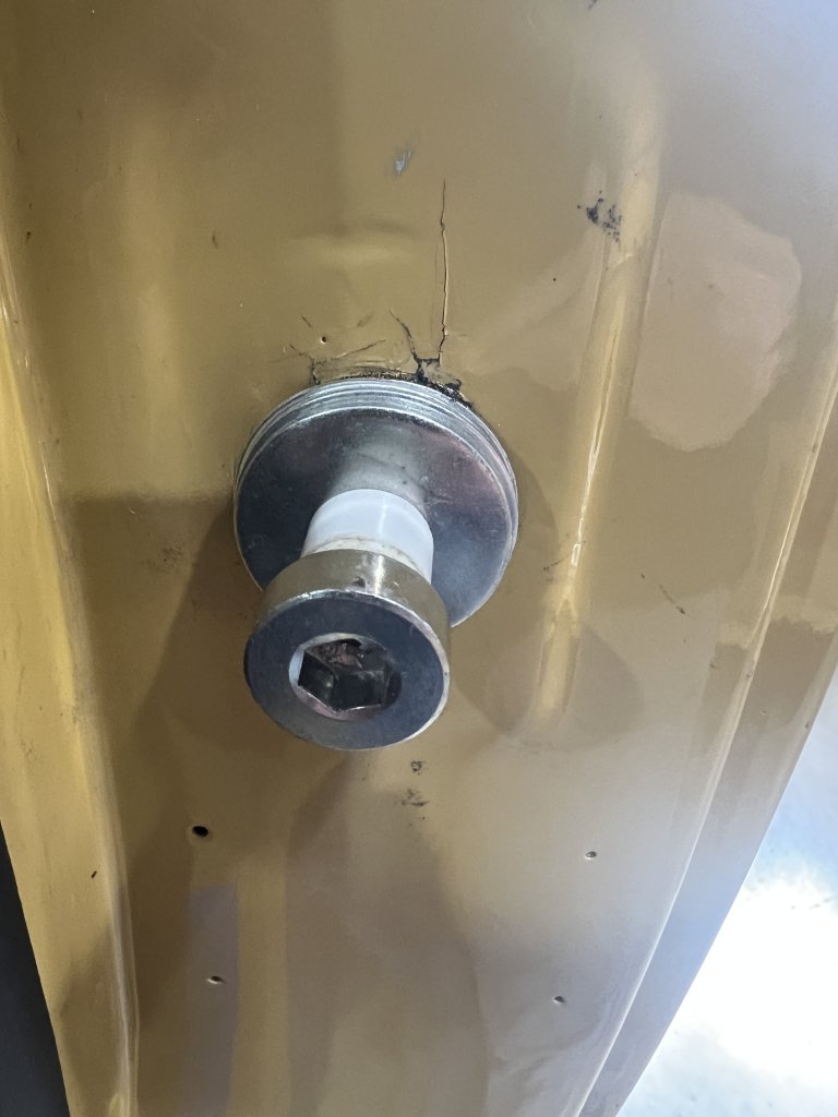

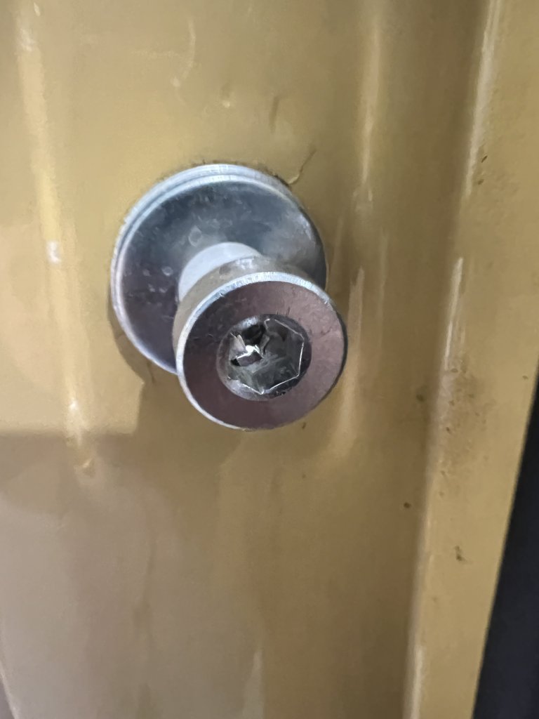

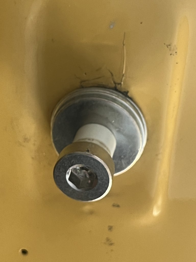

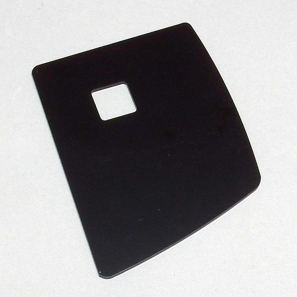

I was seeing if anyone else has had this issue and have they done anything about it? My 1973 Blazer door strikers are starting to crack the metal around the nadar pin. My plan is to have the door hinges replaced and then reinforce the door striker. The body shop is going to weld the cracks and then my plan is to have them weld on the door striker repair plate.

I had that problem once,all it took was welding,hinge bushings and door adjustment. Problem solved in my case.

Unbolt the striker, use a small drill bit to drill out the end of the cracks, weld them up, grind them down, I remove one of the washers they have stacked and replace it with a fender washer that I then tack weld in several spots to the door jam.
For the rattling, get some pex tubing like others mentioned. I walked around my place with a tube and a cutter and replaced the bushings on the whole fleet lol

Here's some pics in regards to the backside. I had to search online for a full top since we don't have one in house. This '73 shows the B-pillar being fully enclosed, just like the '77 and '79 we have here. I would assume it's striker is captured on the backside like these are. To the OP, that means you won't be able to put a reinforcing plate on the backside, it would need to be on the front side.
These are the inner pillar covers once they've been removed
Here's the backside of the striker.
This '77 has been reinforced on the front side, presumably for the same issue
Pass side has not cracked through yet but does show stress
