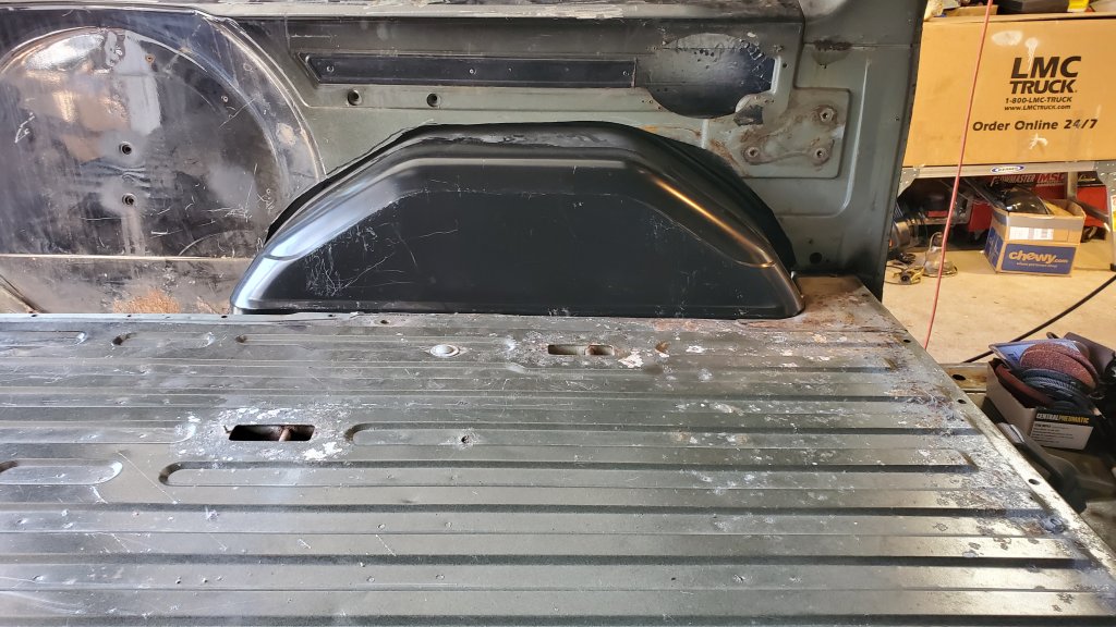

I used the wheelhouse's for the pick-up,they are a little longer but worked out perfect

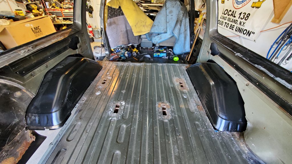

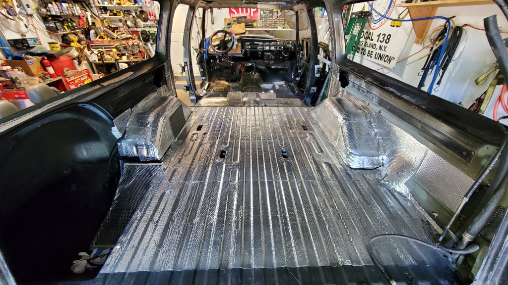

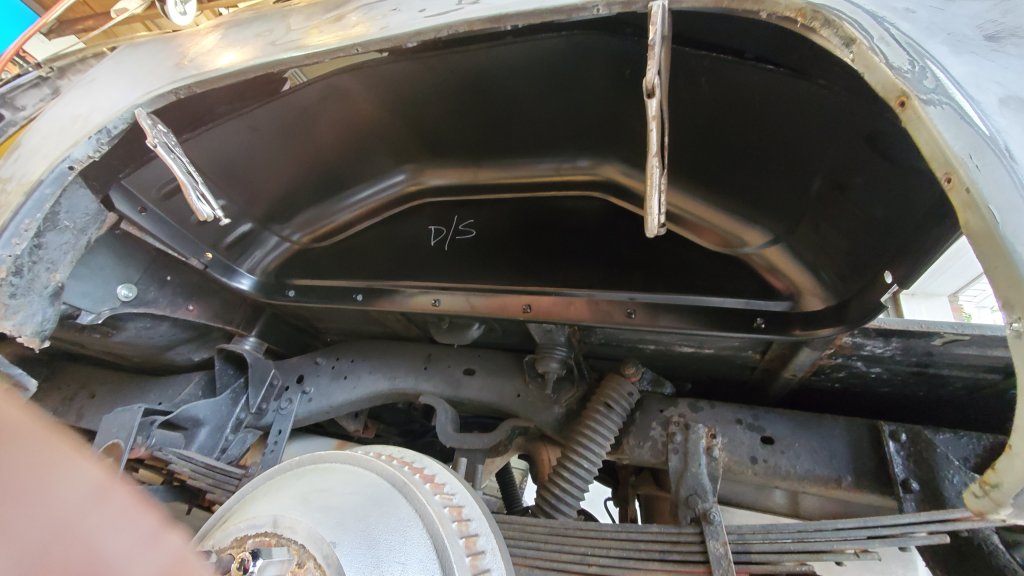

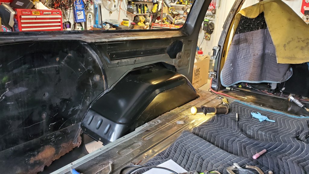

Here's a few more pic of getting them roughly in place. They were a lot of work, but no other options really. I bought 4 pieces total,each side has two halfs that bolt together. Inner/outer.
They fit the inside of the quarter panel perfectly and the depth matches up to the cargo floor but the tubs are about three inches taller and 3 inches longer overall.
Drivers side needed to be sectioned to clear spare tire
Anyway it really worked out and from outside looks almost factory. I didn't want to make it seem like they drop in,they don't

Does the 3rd row seat still fit with the truck/K5 tubs in place?

3rd seat fits fine.i regards of seat fitment the wheelhouse is only taller, so seat w/arm rest's fits between no issue. The only other thing that might be a small problem for some, would be reusing original wheelhouse molded carpeting...not sure though because i bought all new carpeting and everything fit fine and looks great. seat belt retractors fit also.
