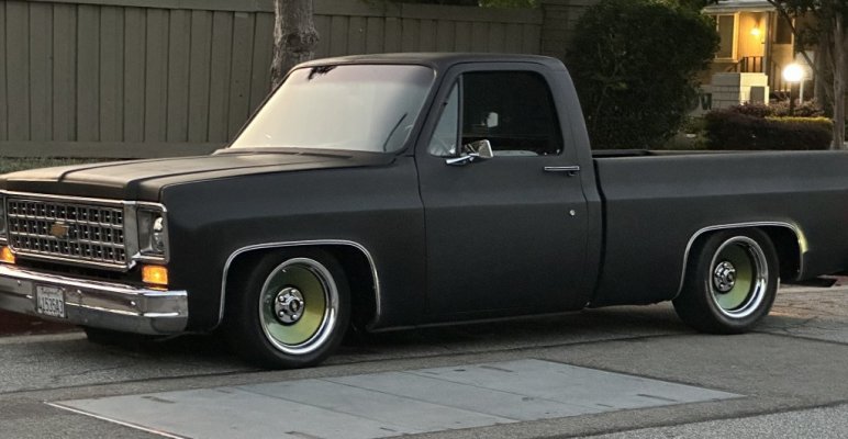

I have 76 c10 fleetside, and have a th350, and recently added a tach and on fwy rpm if 5000, so I been told to change gear ratio ? Then told it won’t fix problem ? And to switch to 700r4, and been told from owners who’ve done so, don’t like 700r4 ? Gears seems to be the best cost wise, but I need some true advice from someone who really could help me out on what’s the best route to take, cuz the shows are coming up soon and I can’t get on the freeway? Thanks

5000rpms = 90mph and 4.56 gears with the tires in your pic (I assumed 28” tires) and a 1:1 final trans ratio.
