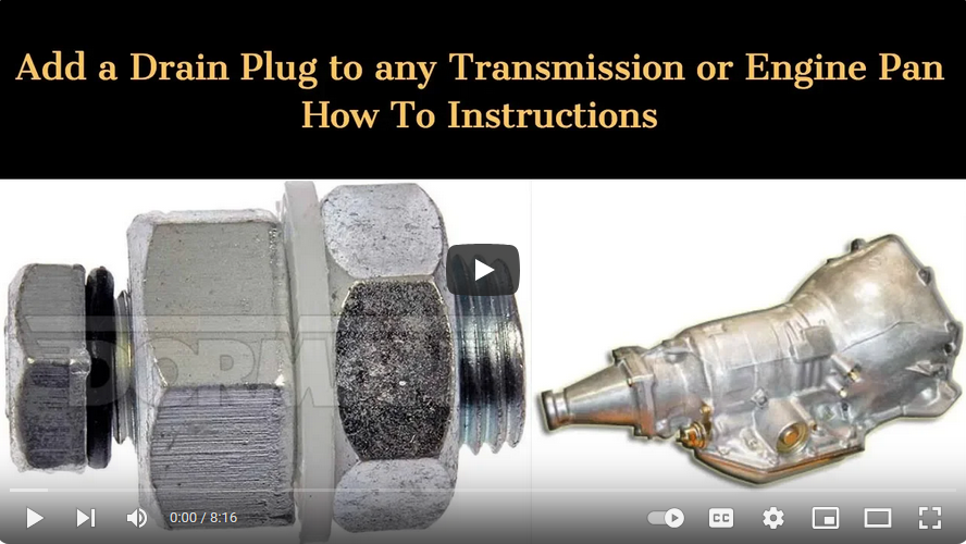

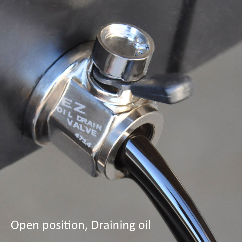

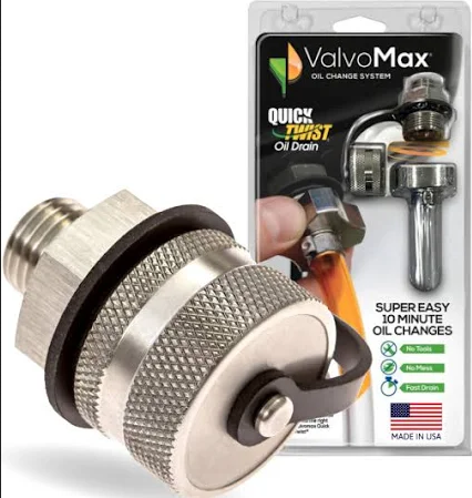

The plastic bag thing is an interesting idea. I wonder that other stuff would work. Maybe lift the rear end of the truck or park on a steep "down hill" road. There are also various different types of drain plugs that have valves to stoop the flow. You could pump the fluid into the diff through the "valved" drain plug.
Although if the diff cover is already off, there are many ways to get the plug out, including adding a secondary fill plug.
