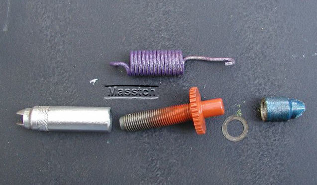

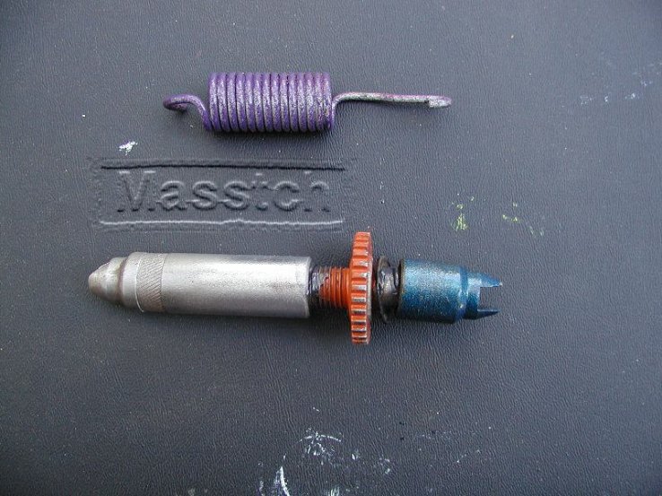

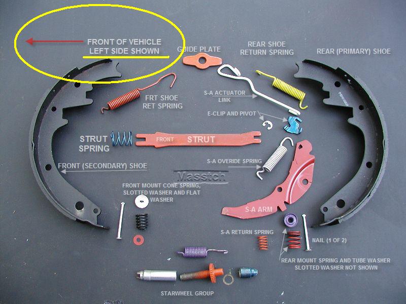

Looking from behind the backing plate, you want to roll the star adjuster wheel down.
My reasoning is like this: The left side adjuster is normally threaded (i.e. right hand). So to decrease it's overall length, you would rotate the star CW looking forward. That would be down - if working from behind the backing plate. Right - correct?
The RH adjuster is LH threaded so to decrease it's length it would be rotated CCW looking forward. That would also be downward when working from behind the backing plate.
Here are 3 images showing the LH side. I'll let you figure it out:
