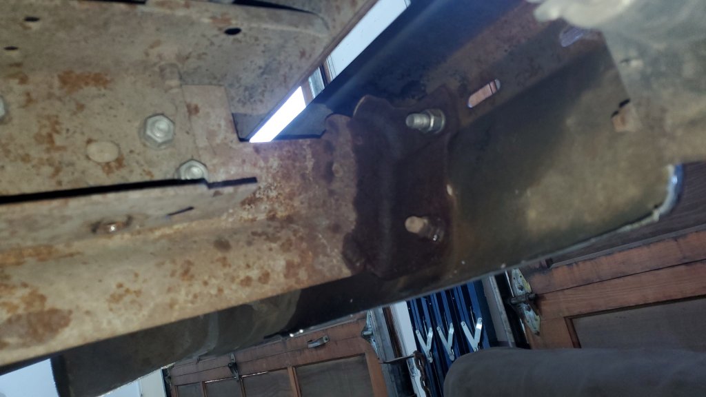

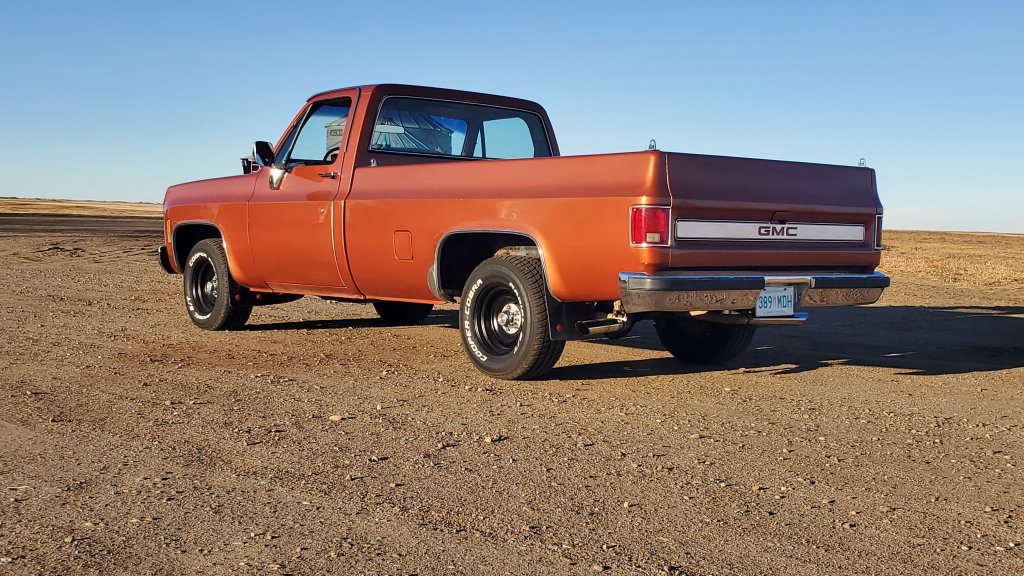

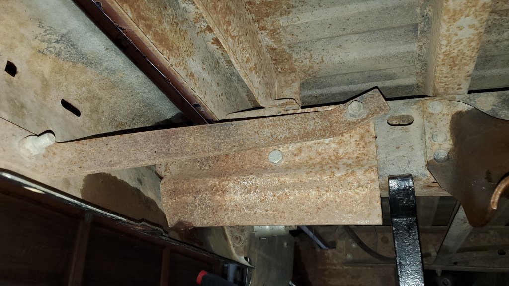

You can see in the first pic the bumper i currently have. This is not the original bumper the truck came with, it was put on by one of the previous owners. I like the way it looks but the chrome is pitted very bad and its scratched up pretty bad from use. I'm almost positive its a 81 and newer style bumper and the previous owner modified the mounts to make it fit. So if thats the case it would be easiest to get one for the same year as the bolt holes should match right up. I'm just not sure how much difference there actually is for the proper bumper because i dont have one.
Ah, that's a 88-91 suburban bumper.
With what you have set up there, you should be able to swap to a 73-80 sport bumper on there without much issue. The outer bracket you have is homemade, and will transfer easily. The center bracket looks like a factory 81-87 (88-91) bracket modified to bolt on. The bolt holes on that will line up the same, although you may need to add some washers behind it. I'd say that's completely doable without having to modify anything or spend much.
If the center ones dont sit well, you could take what you have there and modify it, or make a custom one like I made. Very easy.
