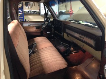

Mahogany pic
Ok yes I do

Well dang, that looks nice already. The headliner you will just have to recover, with new material. Should be able to get it from an upholstery shop. Everything else you replace will just have to be painted with interior paint. Original maroon/burgundy panels would be a good foundation. SEM ColorCoat is what I would spray them with, there should be a color available that's close to the original brown. You MIGHT be able to locate a nice original dash pad in the correct color, it looks like the dark brown pad used with the tan/saddle/camel interiors that was much more common.

Thank you got the reply
Yes, I agree it's a very common interior , it's too bad the color is not offered directly as a replacement . I spoke to a body shop , and yes SEM is what he recommended to keep the original. Color . Thanks for the compliment . Sean
