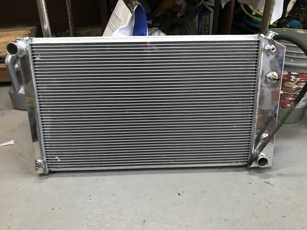

When I replaced the stock 3 row in my '75 K25, I don't recall having to change anything with the mounting or any of the little rubber saddle supports under and over the radiator. The radiator came with a cap and I didn't have to buy anything else. I used the stock shroud and fan.
IIRC this is the radiator I purchased for my truck https://www.jegs.com/i/Champion-Cooling-Systems/166/CC161/10002/-1?year=1975&make=GMC&model=JIMMY&submodel=HIGH+SIERRA&engine=V8+(+5.7L+/+350+) .
This radiator replaces a 17"x28 1/4" core radiator, which is the right size for my truck. However, yours may be a slightly different size (e.g., 19" tall or even 26 1/2" wide).
I looked up the radiator size on rockauto.com, which usually lists all the options for each year, and then matched it up to my truck.

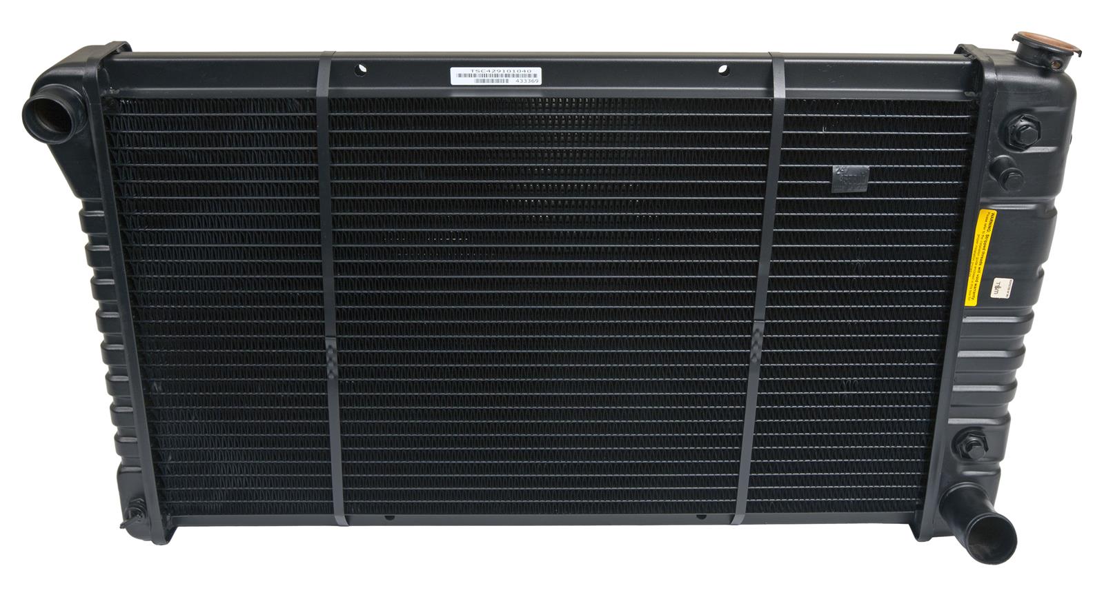

@Octane Where did you get it from? And how many years ago? Factory brass radiators have not been available over the counter at parts stores for many years now. But there are reproduction units around for about $300 - $500 on the web. No idea on quality though.

@Octane I you scored a new brass radiator in the last 10 years or so though traditional sources you scored big, they haven't been around other than specialty reproduction units in sometime now.

@AuroraGirl ya, you can get reproduction brass units but your gonna open you wallet to the tune of about $500 as I have looked. If you have seen a brass rad for a square for a reasonable price let me know, I'd be all over that.
