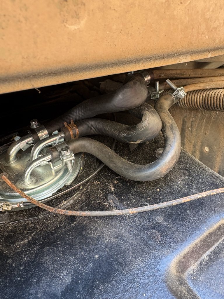

Brian
Just be careful when leaving the fuel lines long. I made mine longer and they ended up kinking.
