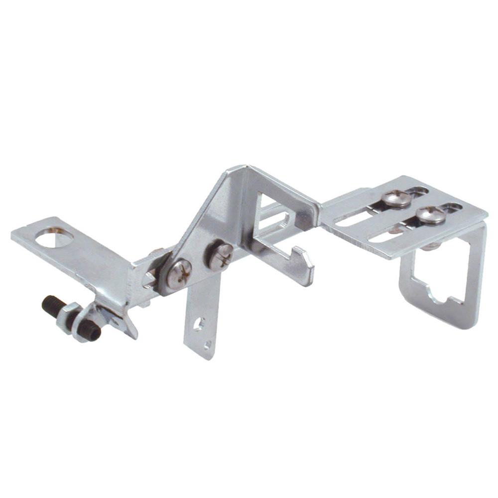

I have the same set up except its a two wheel drive. I even have the AVS2 carb and everything. I don't know exactly which brand the bracket it is because my dad put it on and then later gifted the truck to me, but it is very similar to this one. You mount in on the left rear carb stud through the hole on the very left in the pic. The only issue I have is from time to time the bracket will come loose and swing back and forth with the throttle cable movement, which affects the kick down cable position causing the transmission to not downshift as it should. I haven't tackled that problem yet because I just pulled the engine out, but I would try a lock washer on the stud or maybe a nylock nut to keep it tight and resist backing out. Unfortunately, there are not too many better options with an Edelbrock carb. I think they do make a bracket for their carbs, but they want an astronomical amount of money for it.
