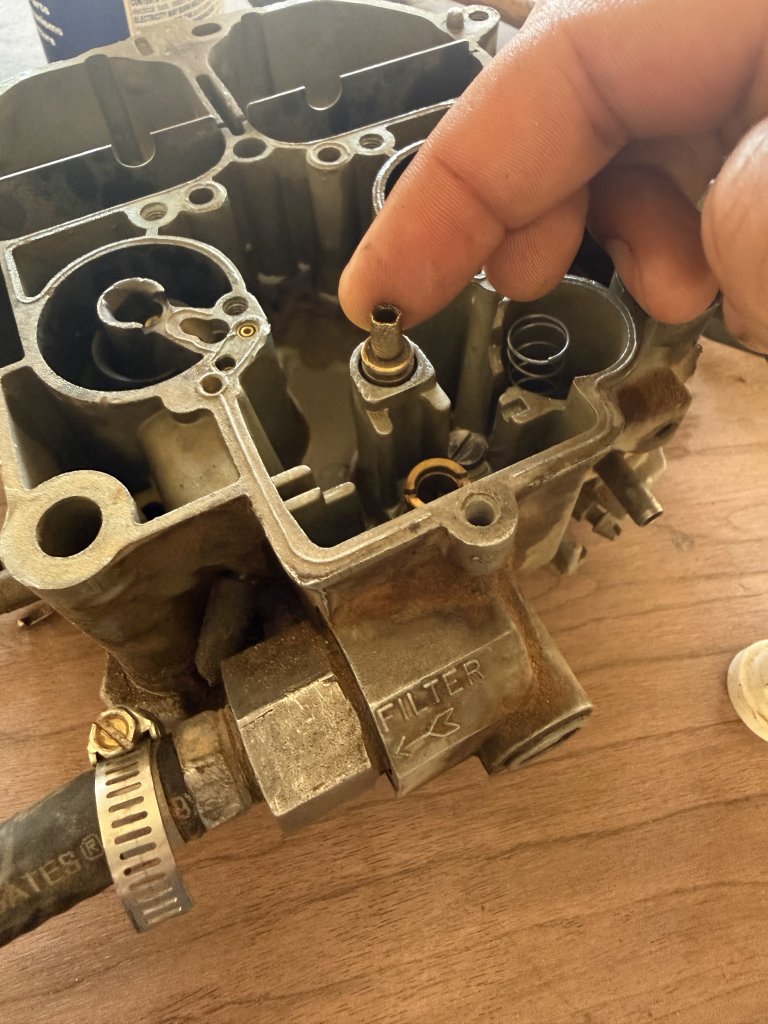

power valve stuck in place won’t pull out

Will it move at all? I’ve found that if they aren’t seized, depressing and letting it come back up from the spring pressure a few times generally gets it out.

yes it moves up and down but just won’t come all the way out

A little WD-40 never hurt anything either. Unless there's a burr or some other mechanical issue it's probably just built-up varnish. Use some lube and keep working that thang.
If you keep pushing it down and letting it pop up under its own velocity,it will pop out.
^^^^ This
This is how I was taught to do it

i’ve been pushing it up and down multiple times sprayed it with wd40 used pliers nothings working

Laquer thinner maybe to bust up the varnish....
