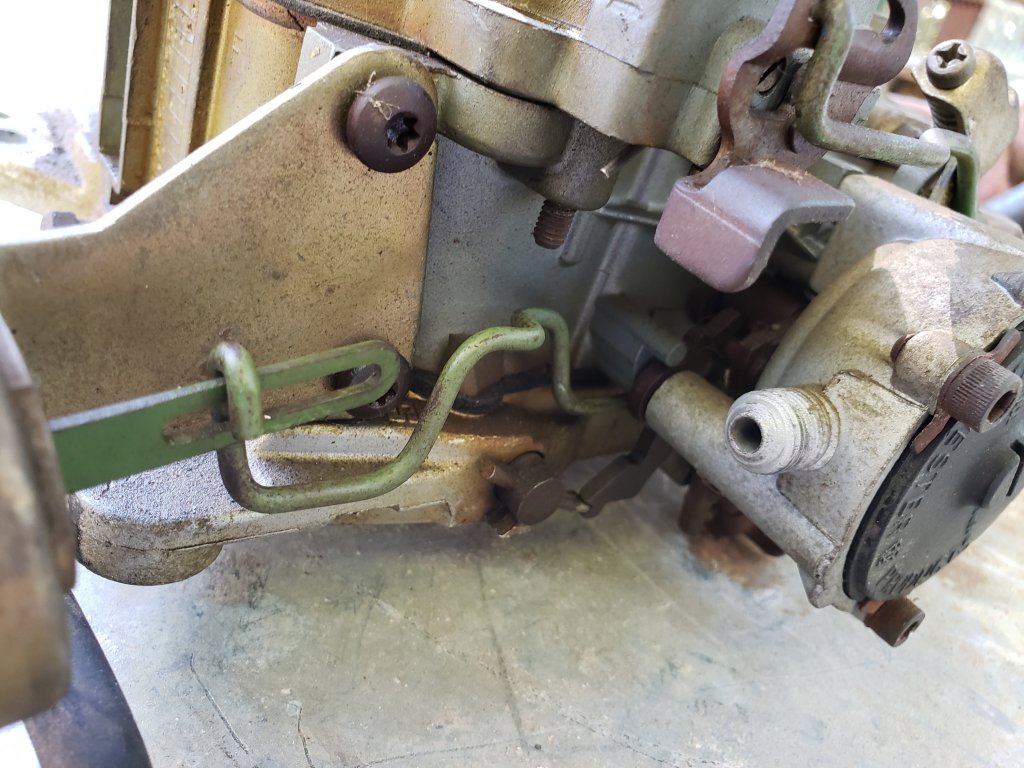

When I pulled the carb for a rebuild I noticed this linkage was not connected at the diaphragm (see attached pic), I rebuilt it and reassembled it with the linkage connected to the cam follower under the thermostatic coil in the only hole possible. It just fell out of the cam follower and is no longer connected under the thermostatic coil, anyone know what would cause this and the fix? It looks impossible to get to without removing the carb again, does anyone know a trick to reconnect it? I see some models have a choke closing assist spring on the diaphragm this one doesn't. Would this make a difference? Its a 17080512 R-4-M4MC hot air choke model. Thanks in advance for any info!

Thanks for the reply but it's the other end of the link that's out. That pic is prior to removal and rebuild just to show the linkage had been disconnected for some reason. I put it all back. Gonna get a mirror and lots of light, stand on my head and see if I can get it back. If not it's remove the carb time again. Still hoping it's something simple I overlooked.

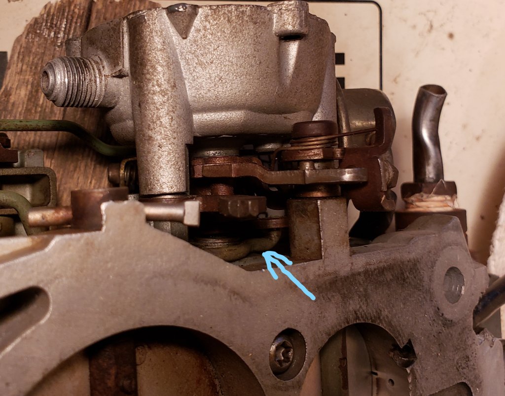

Ok, learned that simple isn't in the cards, no way to see or even feel where this goes when carb is installed. I found out that when I re-piped the heat tubes (I changed from a high rise to the stock manifold) one pressed on the linkage and when the linkage moved pushed it out. Installation tomorrow.
