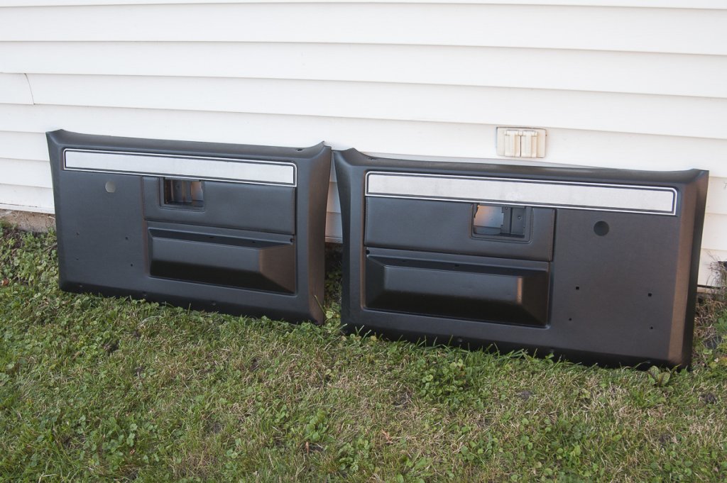

I have used and am still using Colorbond LVP bought from LMC. I have done the entity of the headliner trim and all the window trim. I am converting my all smurf blue Suburban to a blazer grey interior. The colorbond is amazing stuff. Spendy...but worth it, in my opinion. I have used 4 cans so far to do all the interior trim and now and doing the door panels.
I washed / cleaned all the parts with greased lightning first to remove any dirt / grease / grime. Then I wiped down the entire painting surface with 100% rubbing alcohol on a lint free rag. I have used 2 coats on each panel and when dry; you cannot tell that they were “painted”. It is painstaking but rewarding. Here is a of the pic of the progress.
I cannot more highly recommend the colorbond lvp product.

Great write up. I like the pics of the products you used. I need to repaint my interior door panels bad. I will look for this brand, I use this brand striper and know it's good products. Now, my door panels were molded in kind of a off white. And when I rebuilt my truck a shop I heard of repainted my door panels, and kick panels. The kick panels still look good, but my door panels look terrible.
