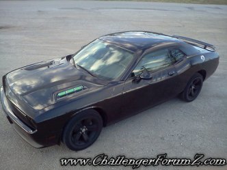

I'm aiming for 400 hp, give or take, I'm wanting to get back the feeling I had when I had my Challenger, I had to give it up a year and a half ago because of bills and my own stupidity of taking off too much work. I'm pretty sure my goals aren't to far fetched, I've been looking at a scat balanced rotating assembly, looking at the afr heads, but those may be a little more than what I want to pay for, as for a carb, I'm not sure if my quadrajet would cut it as is so either have it built it just buy a new one, I'm not a big chrome, polished accessory type person so I'm wanting to keep it looking basically old, the truck is a toy and I'd hate to put a diamond in a turd. Lol pic of my car below.

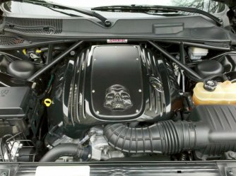

Under the hood! Lol
