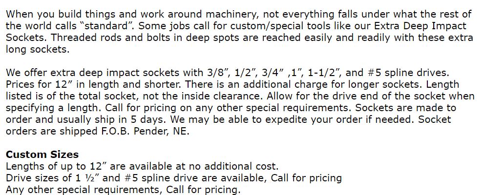

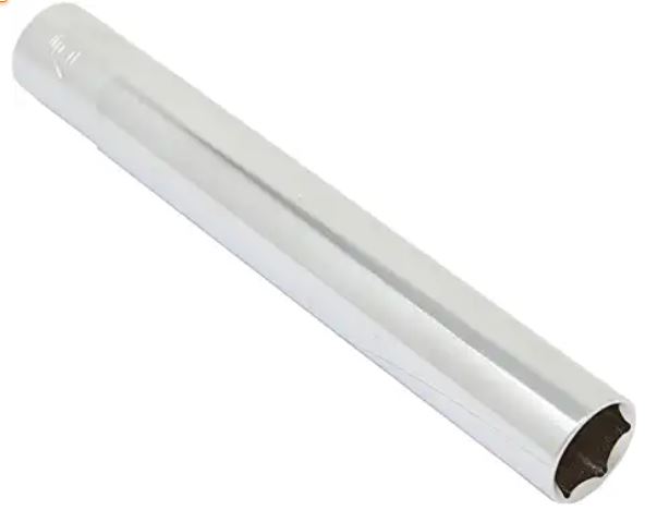

I'd like to know what tool they used to torque that long U-bolt?

I was being serious. Many standard deep sockets will still reach the top half of that nut. Also, extra-deep well sockets are a real thing.
And I'm sure that shop used that to torque all those nuts, as well as the sway bar disconnect bolt that mysteriously disappeared.
Yeah, I don't have a clue what the shop did. I just know that I've torqued u-bolts like that many of times.
Also, u-bolts really need to be retorqued after a couple hundred miles, then checked again after 1k or so.
