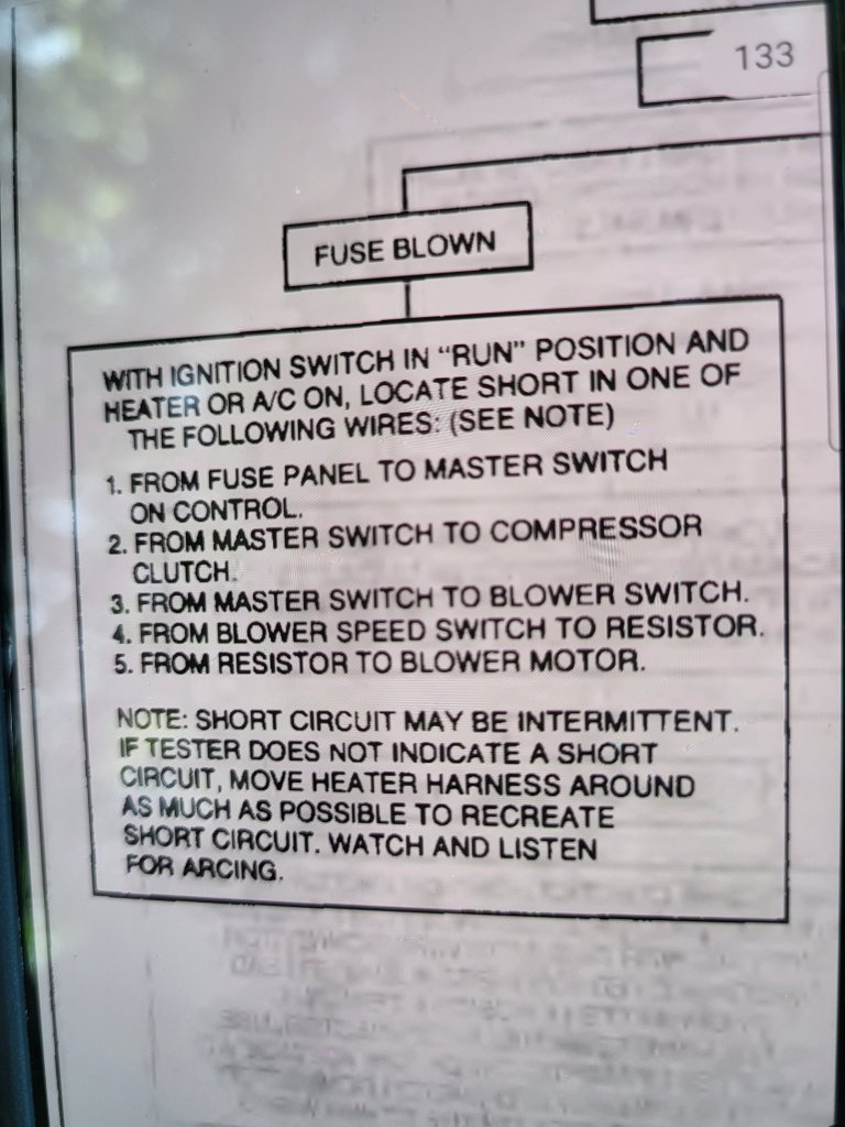

I am not clear on when the issue started, when parts were replaced, or if they corrected the issue. But seems likely there is a short to ground somewhere with the blower motor wiring because the compressor doesn't kick on in the economy settings and the air direction controls are all vacuum based (like going from vent to heat). I think the "high" fan setting maybe uses a relay to bypass power going through the switch. You might see if you put the fan in high, and then turn on the system, if that still blows the fuse.

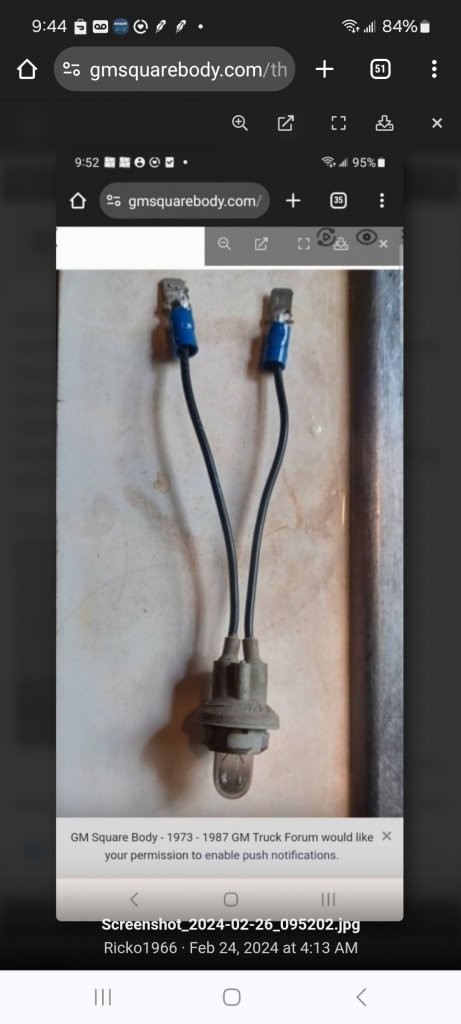

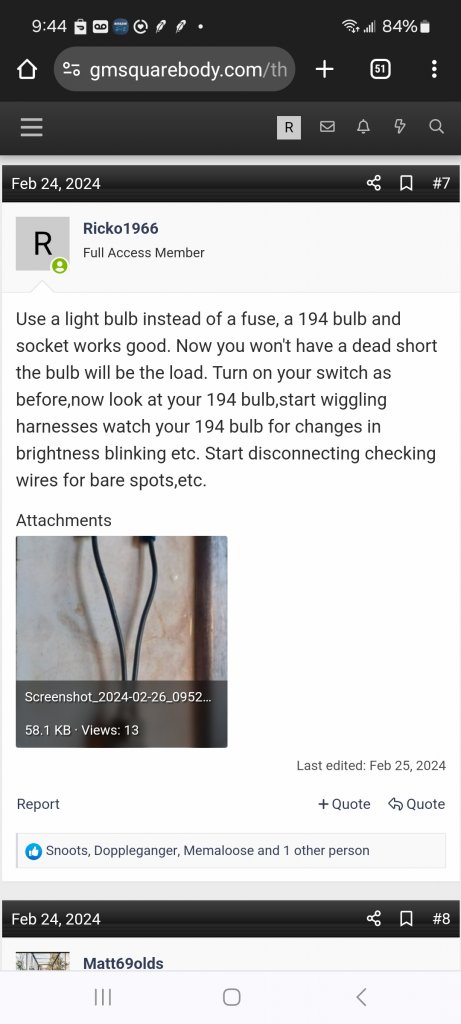

Digital multi meter. Take a light socket for a 194 bulb,crimp a male spade connector on each of the wires to the socket,remove the fuse,place one spade connector in each contact for the fuse. Turn on the key and your HVAC now the light will stay lit,until you disconnect the offending component. Shake all the wires first in case ones rubbed bare and laying against metal.
