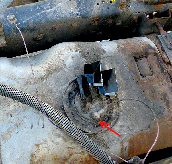

There is a single wire from the Pollack tank switch valve (pink?) that goes to the fuel gauge. Is this signal a 12v, mV, ohm?
Also, does anyone know what this wire goes to (GND? Fuel gauge?).
Thanks.

The pink wire is the ground side of the gauge. The gauge gets power in, the pink wire passes ground through the ******* valve and the selected tank,the sender puts a varied ground of 0-90 ohms of resistance to ground. So for examply 45 ohms resistance to ground through the sender would be 1/2 tank

Is your ‘85 truck a mixture of old and new, because the single wire Pollak tank valve was only used on earlier trucks. Your ‘85 should have a six wire valve. Also, the picture seems to be of the fuel sending unit, not a tank switching valve.

There was 2 different questions - 1. what does the pink wire that goes to the gauge carry....volt, ohm, etc, and 2. what is that single wire with the button end on the sending unit for?
Since I am going to FI, I am swapping in new sending units (and Pollack valve) from an 87. They do not have the button head connector, so am wondering if I even need that wire for FI. My original wiring was damaged and partially hacked - plus is for an 85 - so I have nothing to really go on. Trying to build a new harness from scratch to work with my FI, intank pumps, etc.....and to wire them so each tank has its own fuel gauge.
I think I've got it figured out.
