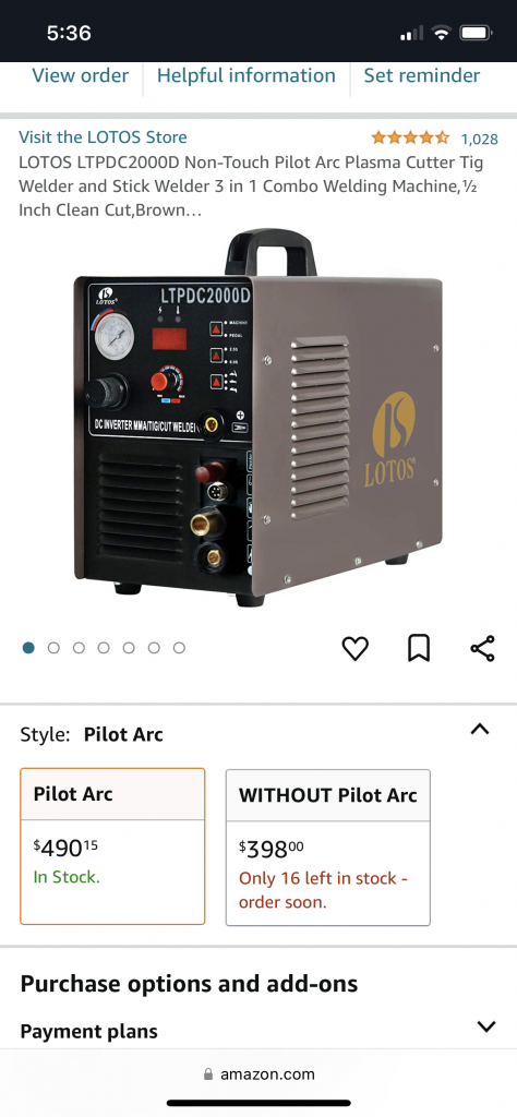

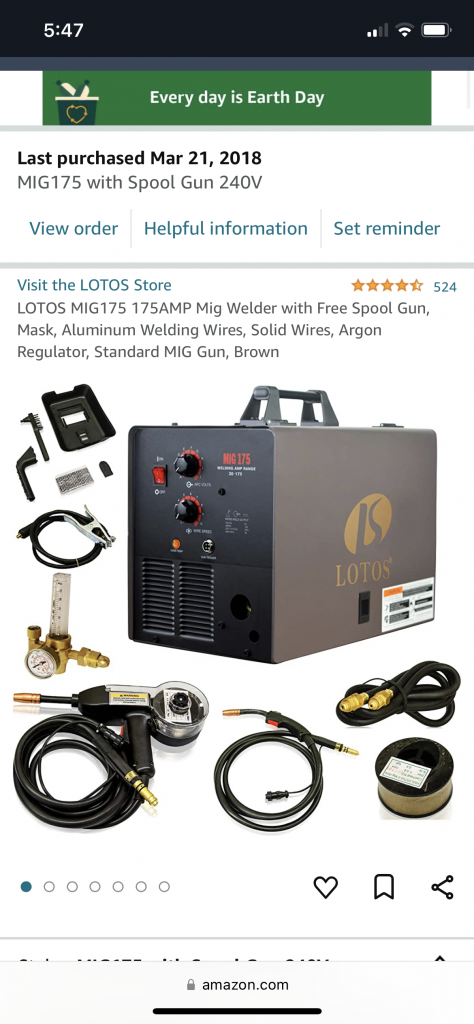

I know a couple of people that bought primeweld units and are extremely happy. I plan to buy a plasma from them soon.
Yes, I have a MIG180 and a TIG225X, nice machines and great customer service.
