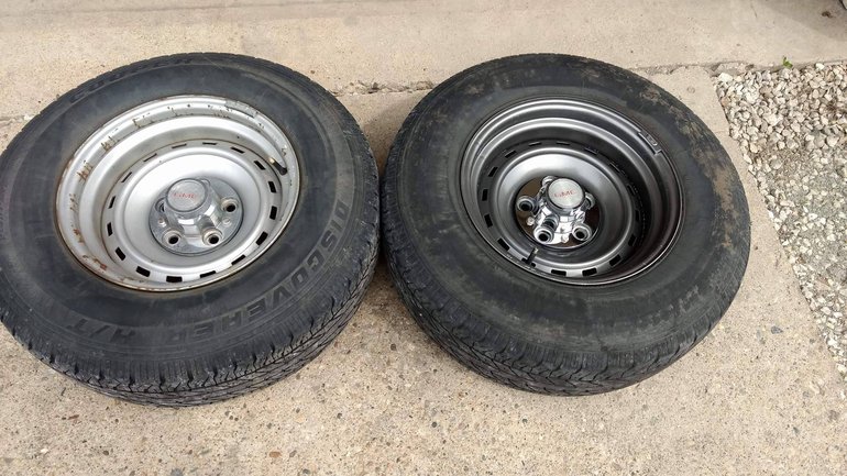

You can still make the rallys look good just sand them down and get the right color paint.

The only trouble with using sandpaper, is that it doesn't get to the corrosion down in the seams. I tried that route with the steel wheels on my '88, sanded, degreased, primed, painted, and cleared. they all started bubbling up from the seams and looked like hell this spring. After only a year or so.

What colour did you use on the wheel on the right? Looks really good
Looks along the lines of graphite, anthracite, or a charcoal.
