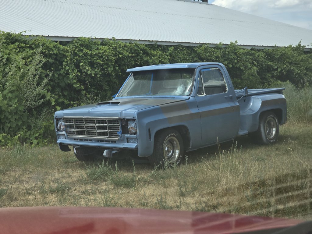

Anyone have any Ideas to add to this paint job. I have red double line pinstripe for both sides of the Grey stripe But it Seems To Need More to it . Also The Clear is not on it yet either Clear with Blue Pearl added to it ?

Repaint the stripe a color more contrasting will be easiest. I vote for a darker blue.
Personally, I'd do a bright silver and bright red pin stripe on both sides of the dark gray. Maybe add a yellow stripe too. Then there are decisions to be made on the order of the different colored stripes, in relation to the dark gray stripe.

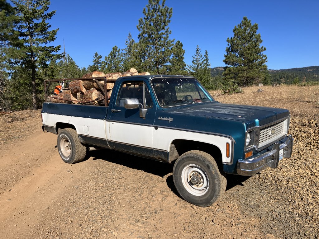

Has anyone used striping tape instead of the chrome strips on the side? This applies to the two color paint schem. You then clear over the tape.
I’ve seen 70s squares with pinstripe in lieu of trim. Looks good.
But I’d never clear coat over it. Bad idea on several fronts with no upside I can imagine.
Biggest being, having to sand and re-spray the whole truck or at least the sides, AFTER completing the paint job.
Second biggest being, vinyl is not a good substrate for solvents.
3rd it just ain’t right.

I agree. I am definitely NOT an advocate of clearing over tape stripes. Some people think it's a fancy way to do things, but not me. It just opens up too much potential for issues in the future.
I think some may have misunderstood. I’ve seen it done in cars that are 30 years old and it’s perfect. They don’t clearcoat a wide swap. Only the tape with a brush it keeps it looking brand new and protects it.
