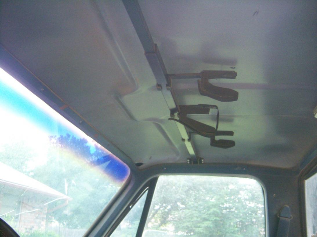

This is in the 85 K10. I'll be using it for sure.

It was in the truck when I bought it. The PO was a bigtime hunter. Deer and hunt stickers on the rear windows, Deer tags in the glove box, hunting regs under the seat etc. He just used it as his hunting truck til he sold it to the guys I bought it from after they robbed the powertrain out of it. They just wanted the motor, tcase, trans and front dshaft, I got the rest of the truck for $200 with the gun rack.
