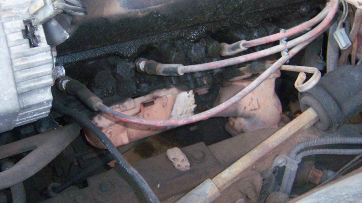

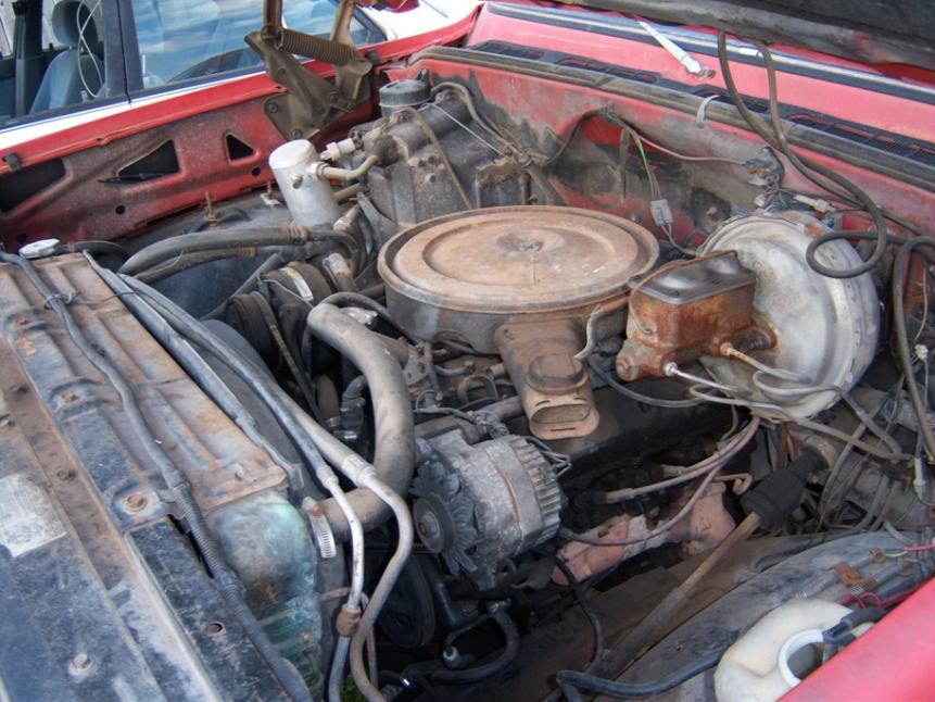

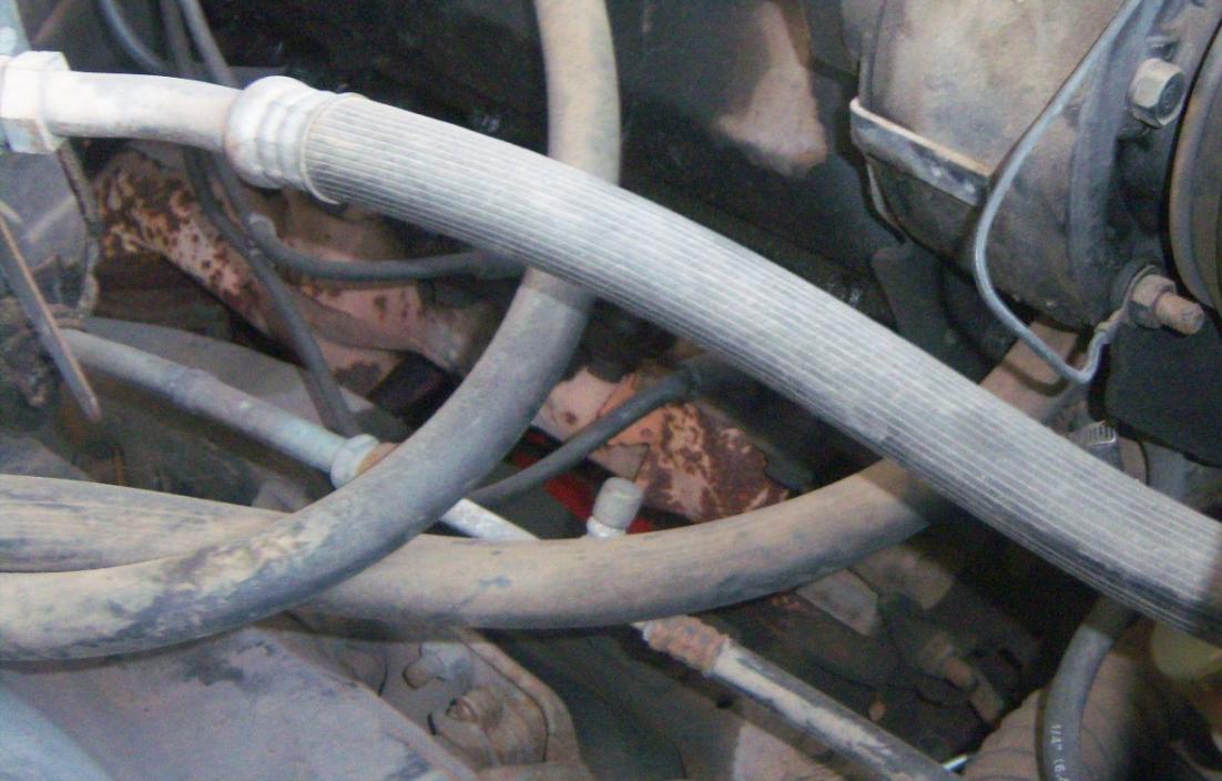

Maybe these will help give an idea of how the motor fits and sits in the truck, and how the manifolds will look. Keep in mind, this is a small block. So I'd imagine the BBO will sit a bit higher and a tad wider on each side. Which in a way, looks like it might give even more room. It appears to me the motor mounts will give plenty of clearance even if you found drop in the middle manifolds. which I think I have a pic of too. I'll see if I can find it.

Oh, and as far as fitament, not real positive. I'm certain there's got to be manifolds that fit, and I know headers exist since there's been others who have ran headers in these trucks with BBO's. Just not sure what body to get them for, whether it for Cutlass, 88, 98 or what. Obviously these 77 Olds 350 manifolds fit the 80 and should fit an 82 the same. You know SBO manifolds will also fit the BBO I'm pretty certain. Now as far as breathing though, not sure how well that would work.
