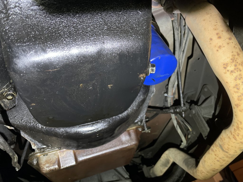

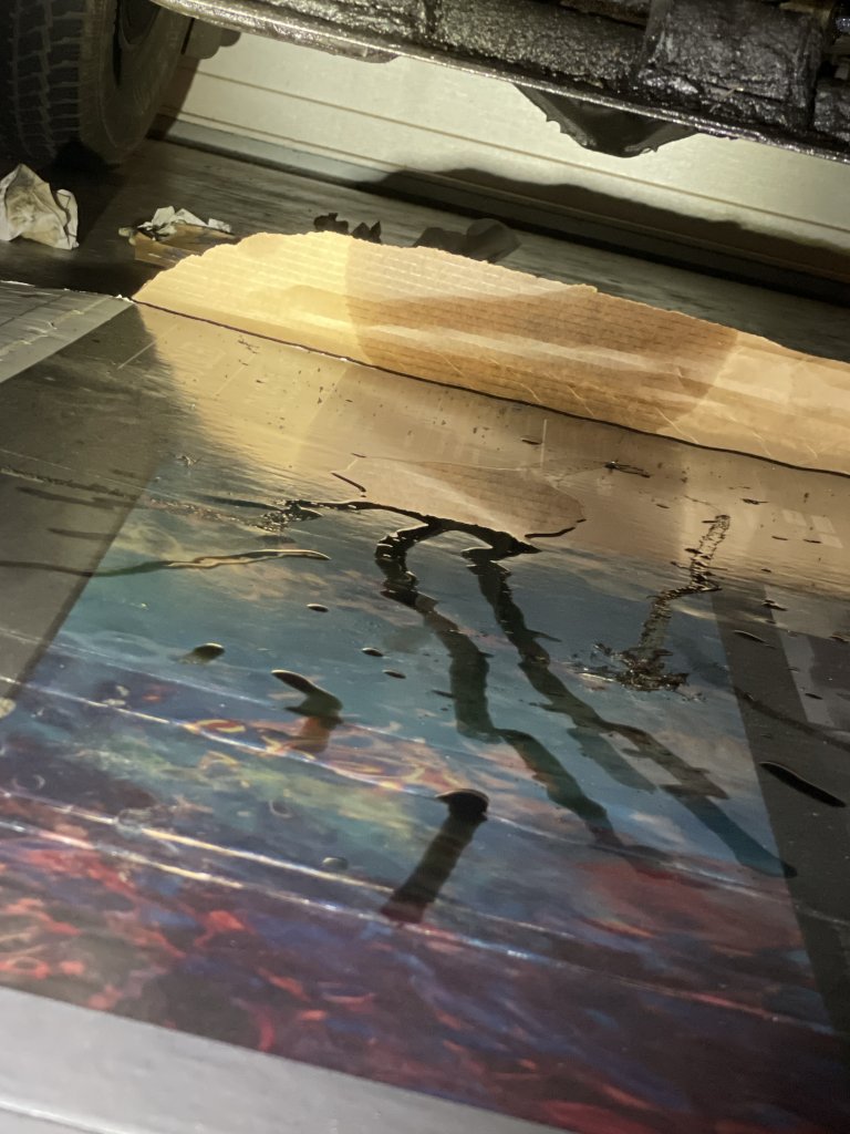

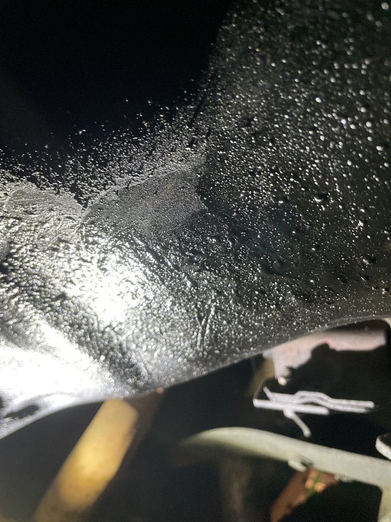

So I have been working on a 77 K10 with my grandma for a while and we got it running and stuff a little bit ago. I have started to notice that this truck likes to leak out of almost everywhere. About a month ago I replaced the pinion seal because I found out my dif was almost out of fluid from a leak and now I am starting to notice a lot of oil leaking from what I think is my valve covers and what I think is the front seal thingy. I don’t know if thats a thing but it looks like oil is coming out of the front of my engine from the belt side. My grandma says it’s normal for old trucks like this to leak a lot but I am starting to worry about the amount of leakage. Thank you for anyone that could give me insight.
The first photo is of about a weeks worth of oil leakage. The second photo is the bottom of the oil pan and the third is right under the pulley thingy I think is what it’s called lol.
Thank you for any advice given and feel free to ask for more photos

It’s common for valve gaskets to leak. They are easy to replace. The puddle of oil is excessive. Could be front main, timing cover, oil pan and/or rear main.
Use some engine degreaser and wipe it all down as best as possible. That should help you to pinpoint the leak a bit better. Don’t shoot brake cleaner at anything rubber that looks like a seal. Ask me how I know…

Check your pcv valve (positive crankcase ventilation) in your valve cover. Sounds like your engine is pressurized and pushing oil out every where it can. Could be compression getting by weak rings also.

Older design GM engines do have a tendency to leak. Valve covers, intake front or rear, damper seal, rear main seal, oil pan and drain plug. Do check the PCV and for excess blowby.
Spot on the floor is excessive, should be fairly easy to locate the worst of the leaks.

By the time that you chase down all of those leaks and fix them with the engine in the truck, you might just want to pull the engine and put all new gaskets in it with it on a stand and put it back in. It will be a great learning experience, at the very least. Just a thought.

I would also check the bolts on the oil pan, and take a look at the two bolts and gasket for the fuel pump. After you clean it, check the power steering hoses for seepage or leaks.
