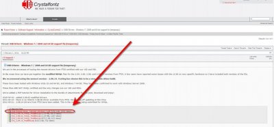

I've got the .adx, .xdf, and .bin files imported into Tuner Pro. It's set up and ready to go. I don't understand what I'm supposed to do with that zipped folder that I downloaded that has the driver. I thought when I plugged it in for the first time, the computer would say new device found, and it would set that up for me.
