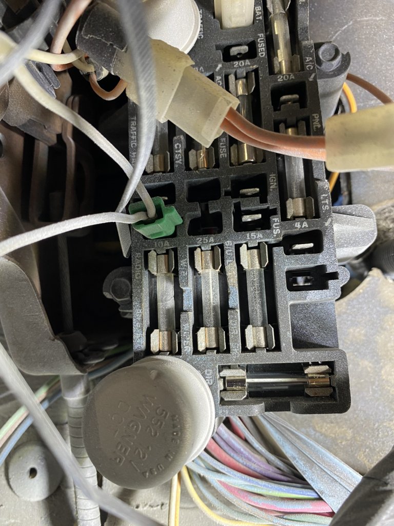

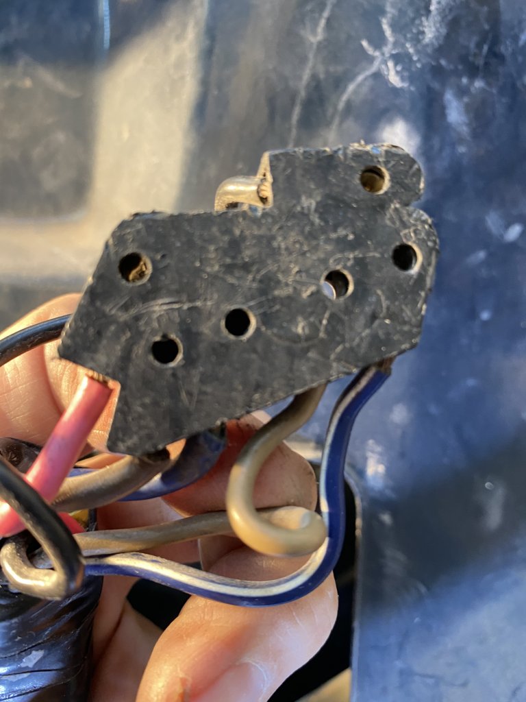

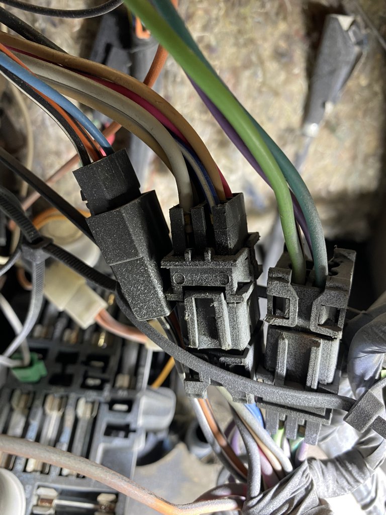

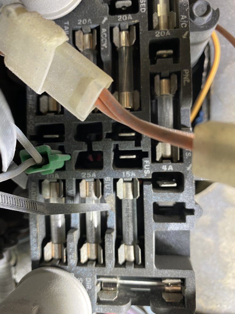

Need help as usual. 15 year olds restoration project. Power windows worked prior to sandblasting. Now as we are putting truck back together no power windows. It is a ‘76 we bought with the PW already installed. I checked, all fuses are go, switched power to other ignition related items is good just nothing to any of the points on the connector in the drivers door. Read here I think Blue is power, but I get nothing when I test it. Any help appreciated. My son wants crank windows anyway, but if I can get these going again I can deal with that another day.
