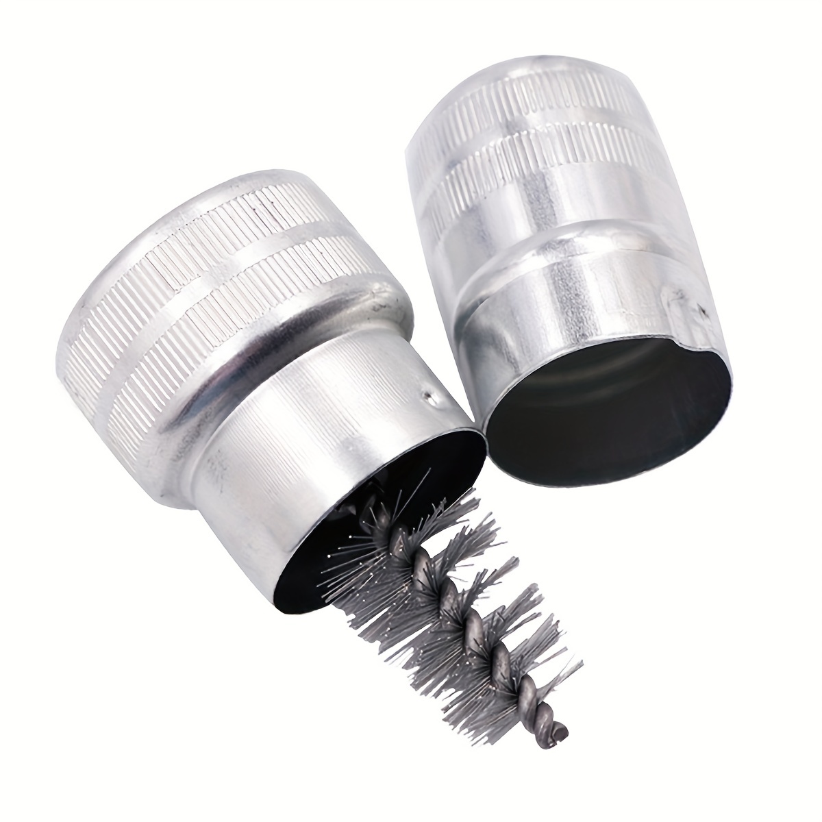

Did you clean BOTH battery posts?? power for lights does not go through the ignition switch.. Here's a link to a battery post cleaning tool, works for both side posts and top posts.. Clean the cable terminals also.
