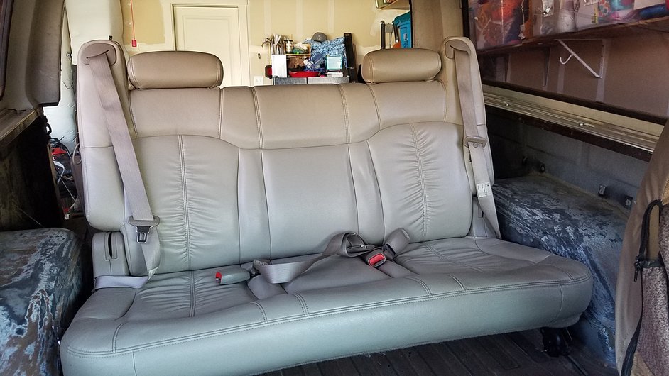

So I finally found a newer suburban third row seat. I got a steal for $100. I was wondering instead of cutting and welding the bottom of the seat, what do you guys think of just welding U-shaped round bar to the floor. Three seperate ones in the rear and two in the front? The seat is basically brand new and dont want to ****** it. Thanks. My search continues for front seats now.....

Look at that, snug as a bug. I think that'd be good or some kind of homemade low profile adapter that can bridge the differing seat designs. Just make sure you don't compromise your headroom, especially if you have any intention of carrying adult passengers back there. I haven't sat in my backseat for a while so I can't recall the clearance, but it should be pretty forgiving for whatever you need to do.

Yeah didn't think of room for adults. I'll have to jump back there to check. I'm 6'1 so that'll be a good test. My kids are excited. I feel good about having lap and shoulder belts for them. Yes really good fit.

Wow....that fits pretty well back there. I look forward to seeing what you fab up to make it latch in!! that's slick!

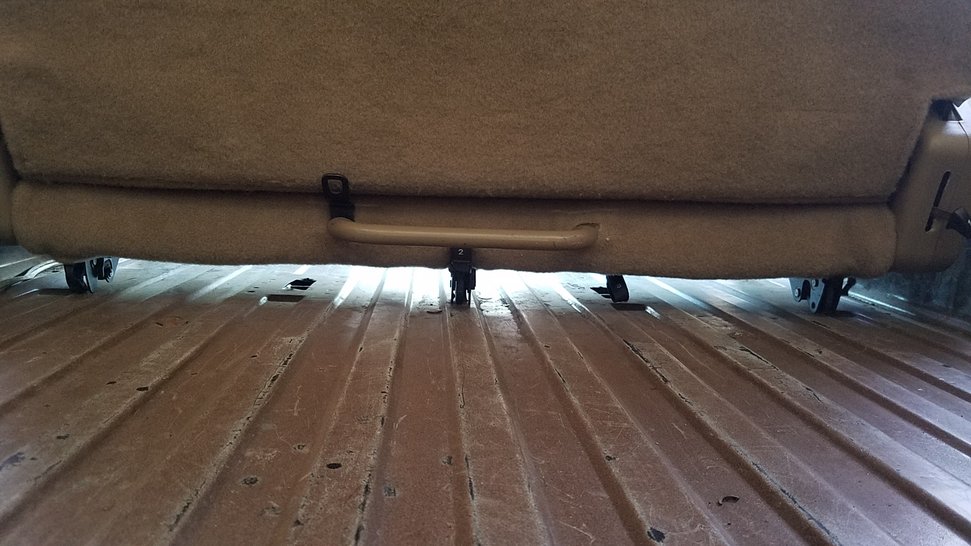

Well I got the seat installed. I sat back in it too. There's plenty of leg room send head room for me. So my kids will have more than enough. I got angle iron and welded round bar where the seat hooks in. I then bolted the front into the original bolt holes for the old one. The back I drilled 4 holes and bolted into the truck. Here's some pictures...Any comments are welcomed.

Here's a couple more... I'm going to paint the brackets and spray some bedliner as soon as it warms up. I will put carpet back in at some point. But next it the two front seats and weather stripping and new top gasket/liner...

Looks good. I thought they sold brackets for these on eBay..?

Not sure about that but if you check on http://www.chevyk5blazer.com there are some folks there that will send you the plans to make your own. Alternatively I think you can check out Merricks garage and he has them on his site https://merricksgarage.com/rear-bench-seat-bracket-plans/
I think that bracket setup is for the 81 and later rear floor pan brackets.
