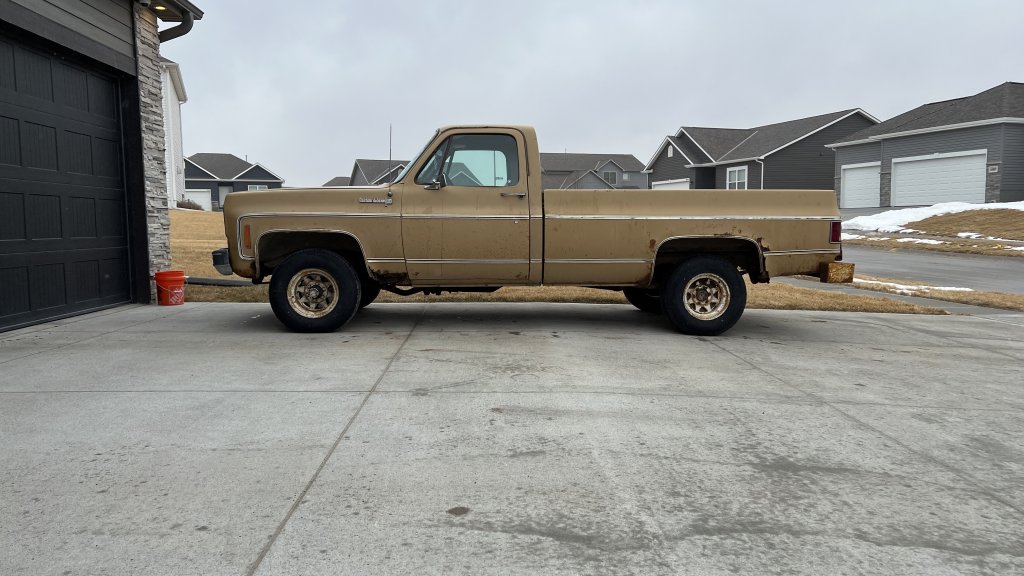

I have, currently, a 1973 bone stock K10. I am about to install a rough country 2 inch lift kit, not using blocks. The truck currently has what I always referred to as white generic trailer wheels And I of course put new tires on it last March when we revived it.

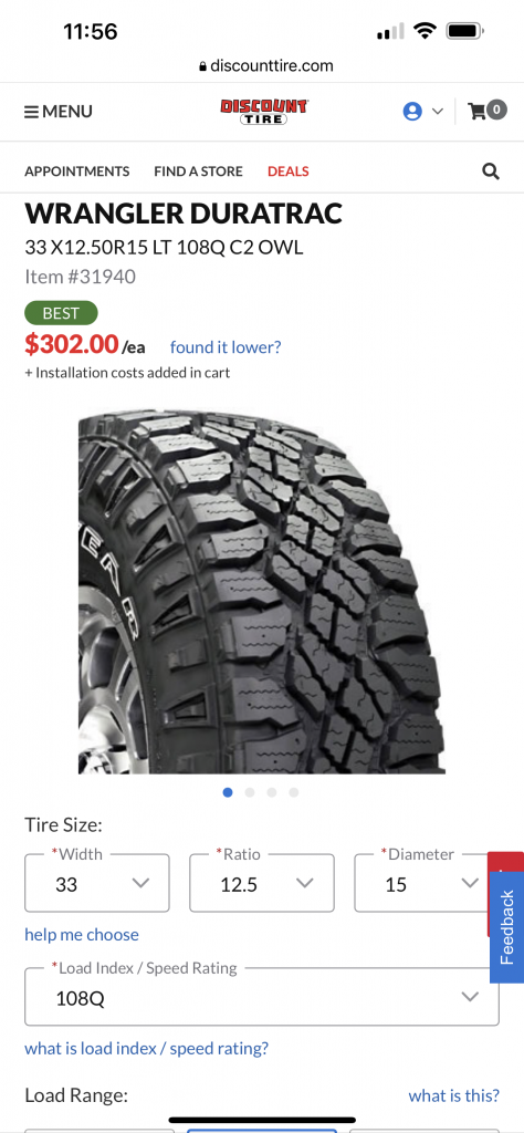

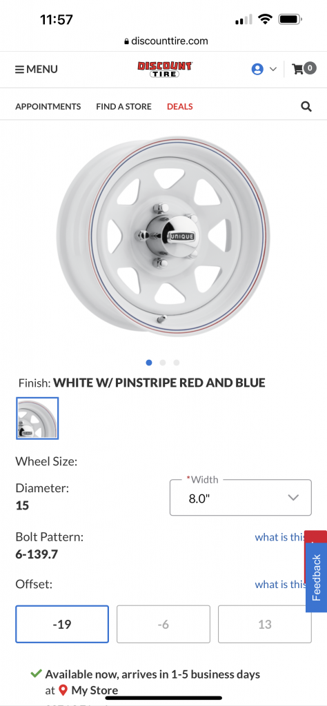

That said, I want to purchase similar wheels because I actually like the look, that are 15x8. And then get some Goodyear DuraTrac tires that are 33X12.5X15.
If nothing else on the truck has been replaced/modified, is there any reason whatsoever that I should not be able to do that as long as the backspacing on the wheels is 3.75 inches?
I have attached a couple pictures of what I was looking at. Far as I can tell, it looks correct although their website doesn’t list anything as fitting this truck. So I’ll have to call in the order, but that means I need to be extra sure what I order is valid.

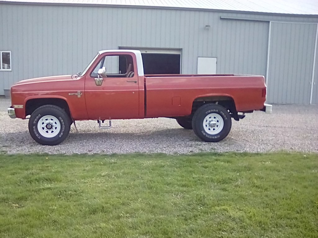

@bbusse That will work just fine. Here is mine with a Skyjacker 2" softride and 33x12.50s on the factory rally wheels.

I actually am a little embarrassed about doing that but THE SAME question gets asked and a picture tells the right answer. I have been on forums where the regulars would literally roast any "noob" that dared to ask a question that had previously been answered. They would say, "Do A Search" and it was toxic and unfriendly. They would all gang up and torment the new guy and that turned a lot of folks away that would have been good members.
So I try to answer the questions that new members ask with as much detail as possible even when we have done it several times before. I need to take some more pics of The Truck but I find that a surprising number of the pics I have were taken just for this forum.

Man, I spot that truck in many different forums. It's a fine example for certain. I tried unsuccessfully to buy a tan/white LB K10 '86 like that back in the 90s. I'd be proud to own it.

Just to be clear, I know a lot of people reference factory rally wheels. I of course don’t have them, what size are they? For whatever reason I’m nervous about ordering the wheels knowing that I’m telling them what I want versus knowing what truly fits, based on a few random forum posts I’ve found.
What I’m looking at:
15x8
6 x 5.5/139mm
3.75” backspacing
-19 offset.
Brian
