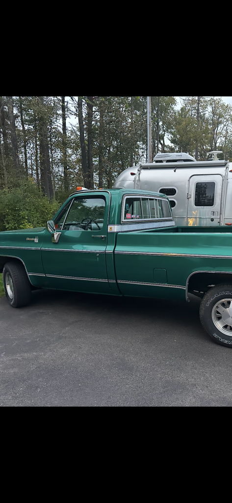

Awesome truck! I too have a 79 C10. Question for you guys. The marker lights on top of the cab dont work anymore. Tried fuzes and bulbs. No luck. Any ideas? Lastly the 8 track radio stopped working on me. You guys know anyone who fixes them anymore?

You might try Crutchfield.com for advice on your 8-track repair. They may know somebody.
As for the clearance lights, if it isn't bulbs or a fuse, it's wires or a switch. There's a pretty good chance the wire got interrupted on its way down from the roof. Find the bottom end of the wire and check continuity from there to the light fixtures, for starters.
