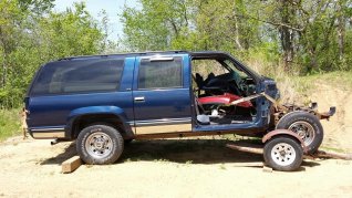

I found a donor truck. Guy states Dana front and rear. Hopefully they are.
Um, unless a solid axle conversion was done on that it's an IFS front diff. You wouldn't use that in a square.
