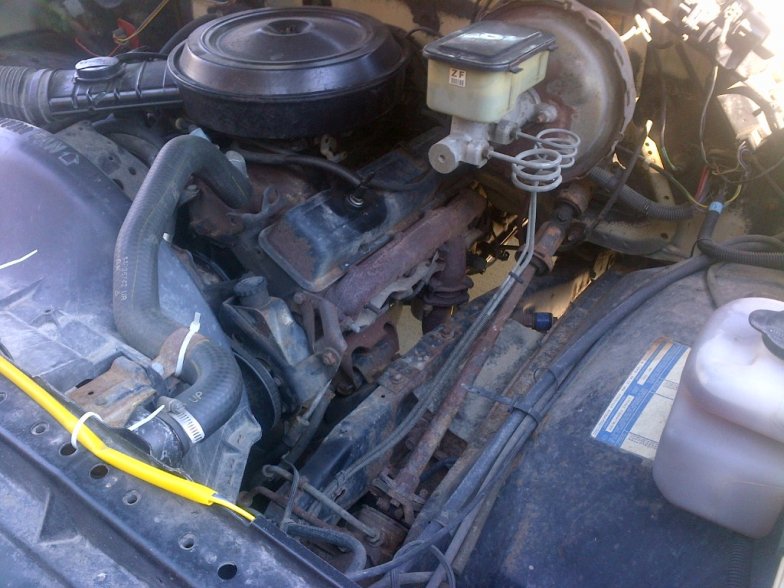

Thanks for the reply. Have never torn into a carb before. When I bought the truck the body and original KM's were what sold me on it. The enigine was filthy and the entire front was crudded over and the valve covers had a nice film covering them. The first thing I did was use a couple cans of engine cleaner to find out where the leaks were coming from. Got pretty lucky. Filler tube at the valve cover was leaking pretty bad, but as it turned out just needed a new o ring. fuel pump gasket was almost non-existant. and the weaping a tthe front of the intake is just enough to after a month make the area in above the timing cover look wet. You can kind of see it in this picture. Also here is an overall shot of the truck. For now.

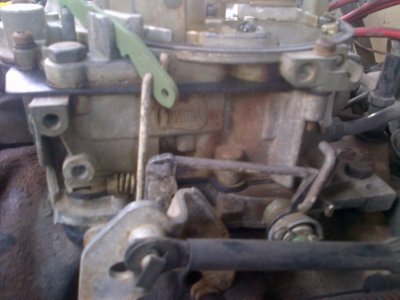

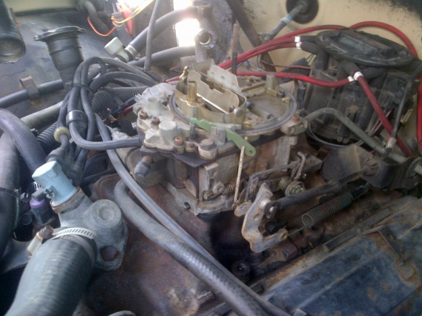

Nope, definitely the quad. Man that intake looks gross with all that surface rust. So an intake is definietly going to need ordering. How hard is it to rebuild the carb? I think I know what gaskets are leaking. Anyone got a nice handy rebuild pdf?

You're lucky. My intake is covered in oil from the valve covers. At least your engine is dry lol

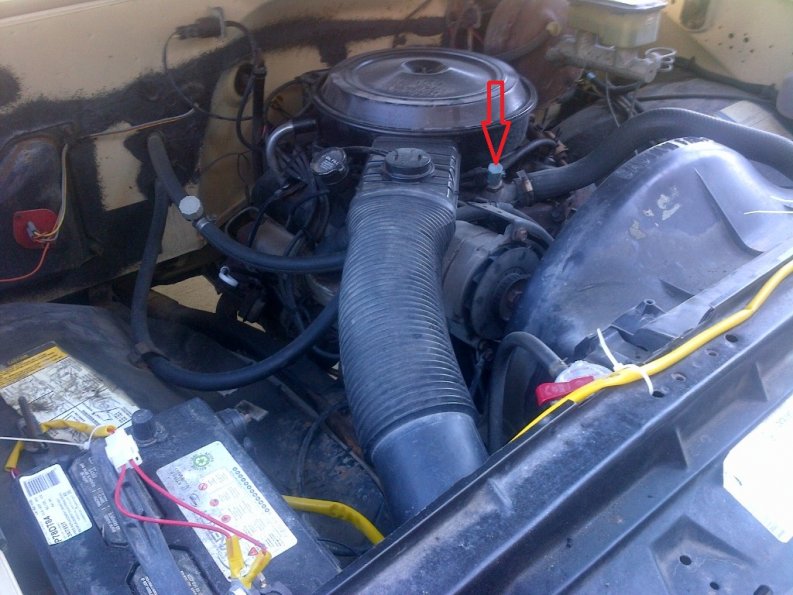

So quick question without really looking into it. what is this sensor for in the water filler neck? I only ask as I am looking around at getting a new neck and filler when I do the intake and carb, and none of the ones on Jegs or Summit seem to have this extra port on it.

That's a thermo switch. It prevents vacuum to certain components until the vehicle warms up. My truck has 2 of them and they both have 4 nipples.
