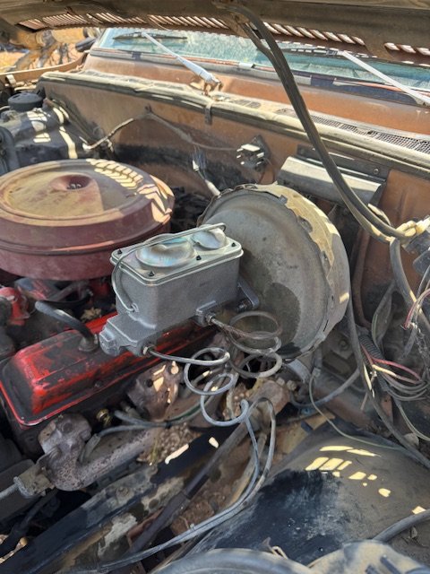

Changed the master cylinder. Pretty straightforward and easy job until the driver bleed valve snapped. I bled from furtherest to closest distance from MC like we do in the toyota world. So the driver was the final one and of course it snapped off. Even after i blasted it with pb blaster.
Nevertheless, i bought a new caliper. I was probably going to end up replacing them down the line.
Now a single lug is giving me trouble. My breaker bar puts an odd angle on it so the nut started to round out. I have been soaking it with pb blaster and even still my brushless dewalt 1/4” hex impact wasnt powerful enough. I ordered a Milwaukee 1/2” torque impact to try and break it loose. I figured if i need it once, ill need it again
Should arrive later this week. I’ll report back more afterwards.

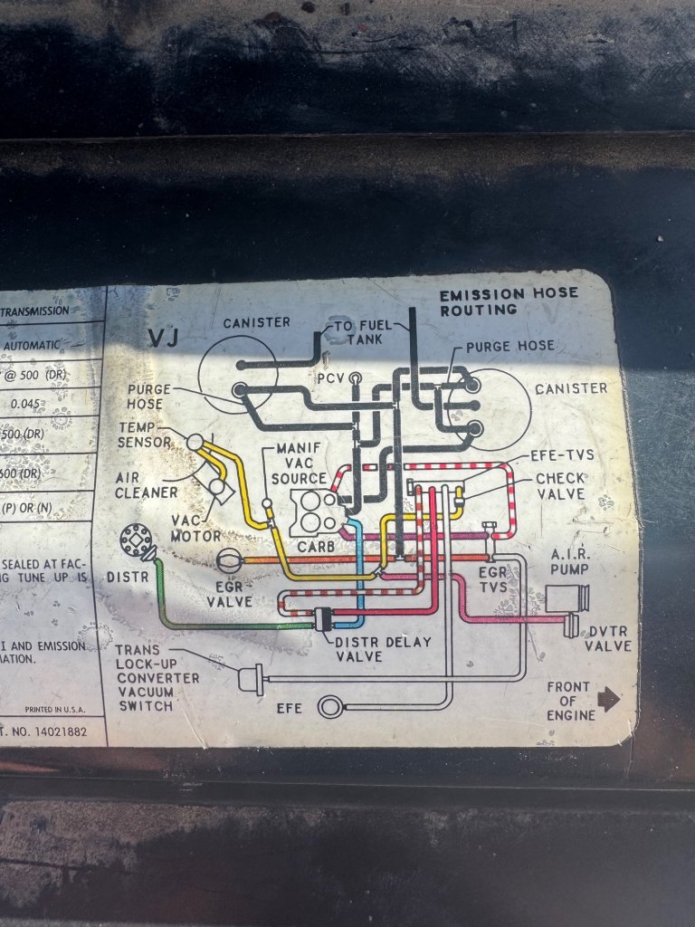

I am also chasing vacuum lines. Many have been removed, snipped or capped. So i am working to understand what in the diagram exists, what doesnt and what is rerouted. Vacuum lines are a new challenge to me so it is a learning opportunity. I want the truck to run cleanly but i feel like i dont need to replace everything in the diagram. I just need make sure what needs to be there is there and routed correctly.
During this process, i can tell the carb is not factory but yet a holley rebuilt carb. It seems that it’s vacuum connections are fewer than the factory diagram shows.
I am open to new carb recommendations but maybe i can clean this one.

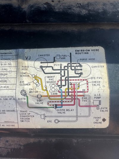

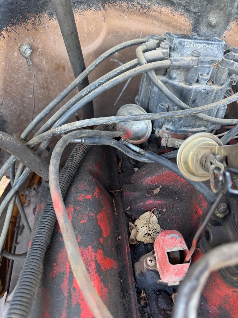

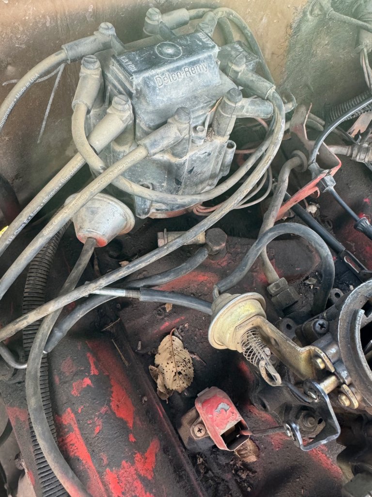

Vacuum game continues..
I dont see an EGR valve but i also dont see an EGR block off plate. Is there something I am missing? Could it be a replacement intake manifold without the mounting location for the EGR?
Note: i dont think it is under the leaf

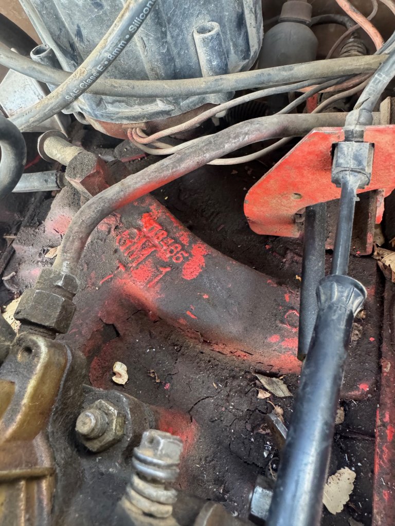

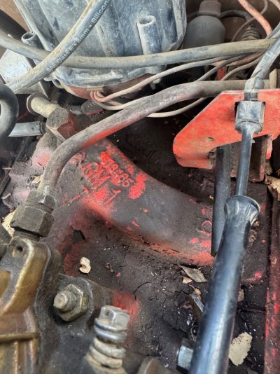

Off of an older vehicle probably.
I think so too. I think it is the same with the carb. Since it is an 1980, it seems to be an inbetween model. There seems to have been alot of changes made in 1981. I have noticed that this model aligns with the 1979 model on some things and a 1981 on others. For example, the oil dipstick is on the driver side which from my reading, is a feature of the 1979 but as per any "put in your vehicle details and we will show applicable parts" websites, the 1980 was supposed to have a passenger side oil dipstick.
I need to find the casting numbers for the block but they are hard to find without pulling the engine.
Here is the casting number for the intake manifold but it is still hard to read:

After reviewing photos of my engine, the emissions diagram under the hood, reading the haynes manual (very helpful btw) and youtube videos, i believe i have the CURRENT STATE of my Vacuum System documented.
Only question i have is about the trans hose. There is a soft-hard-soft line running from the main vacuum source that i need to chase.
Any recommendations to changes or improvements to the vacuum system? Since many of the hoses are old and brittle, I will be changing all the hoses to ensure there are no leaks. Happy to take recommendations into account. I am a newb with vacuum systems.
Vacuum System - Current State
Now that i typed this out, it is possible the engine was swapped to an older engine at some point. Wont know for sure till i verify the casting number
35,425
44,729
That's an older engine. Hints are the 2bbl carb and the orange paint. If you remove the alternator and look for numbers stamped on the flat pad on the block's deck surface, it can possibly be pinpointed where that engine came from.
thanks.. i will do this. did 1980 350s come with 4bbl carbs? According to the trucks vin, it came with a 5.7l v8 350sb. Other than emissions or irreparable damage, i am trying to think why someone would replace an engine with the same one.
