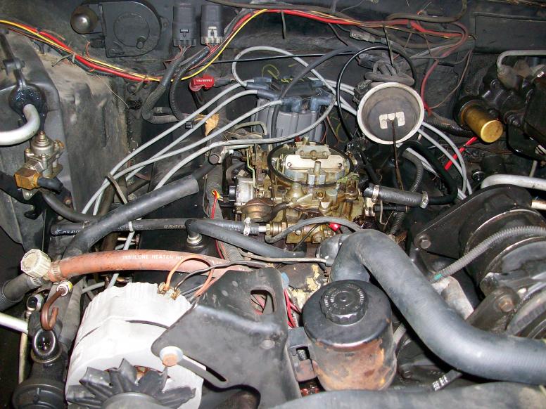

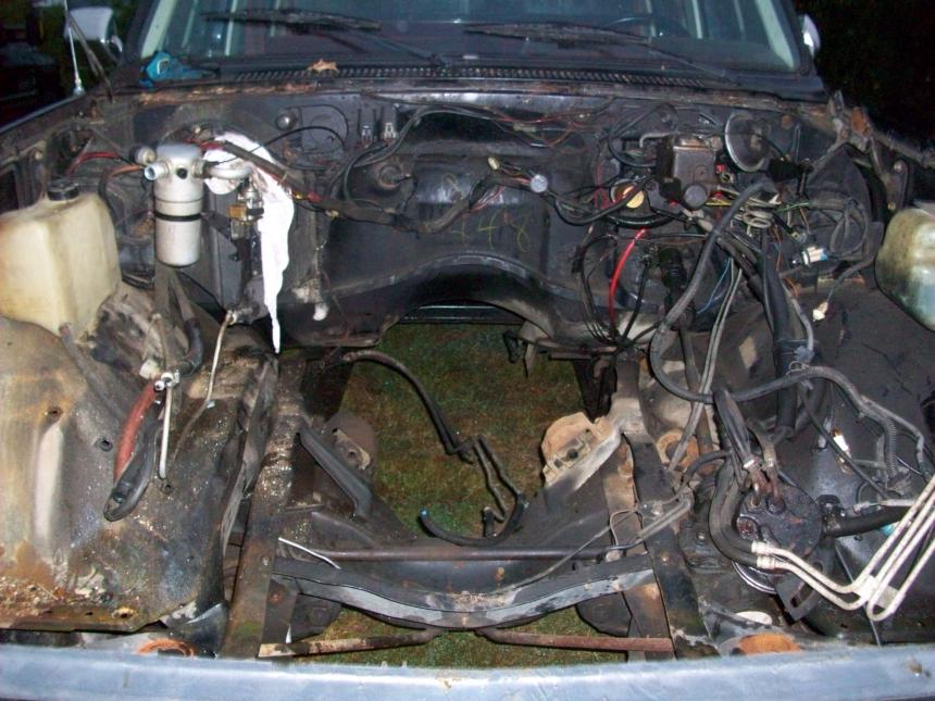

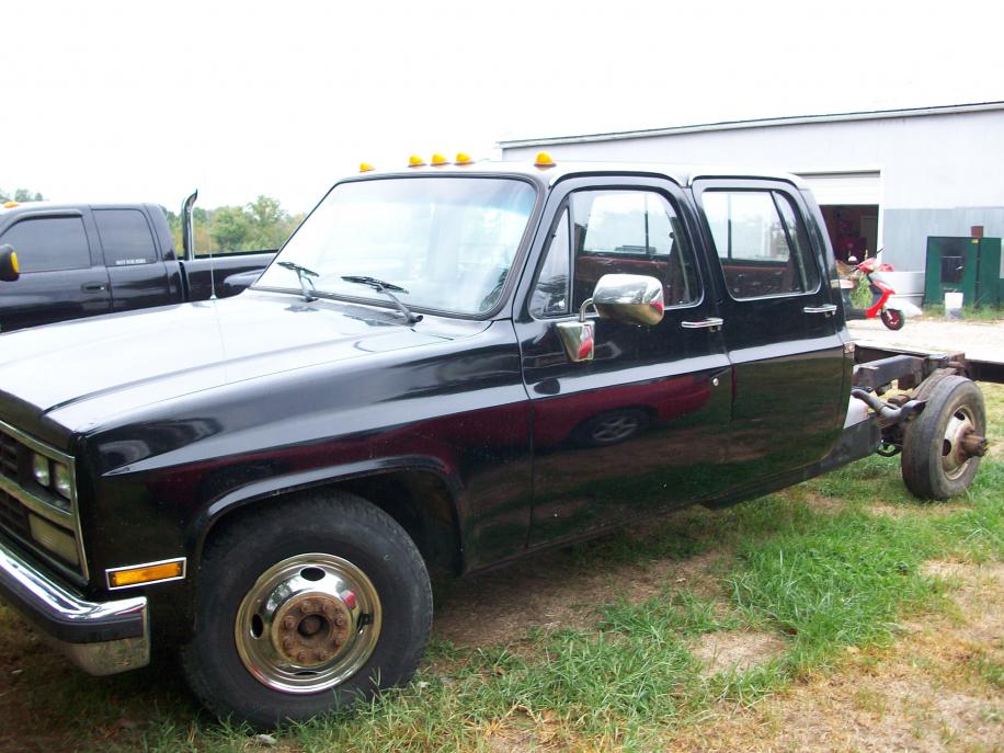

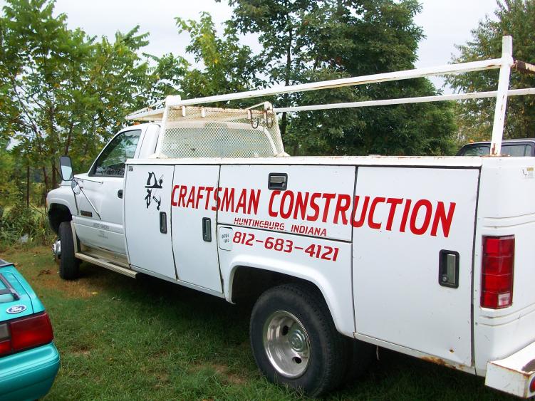

ok I'm gonna try to post these, and it's tomorrow all the way up untill midnight :Big Laugh:
the first is the recipient
the second is the donor
the third is at noon today
the fourth is at about 8 pm.
not a bad day , tomorrow will be cleaning the engine compartment and getting it ready for the new engine

The cab of the black one looks extremely clean!!! I like! If I am ever fortunate enough to restore another square body it's definitely going to be a crew cab!! I want to take a 3+3 but make it a short bed:)

Nice Recipiant. Looks well worthy of a Cummins !!! :grd:
